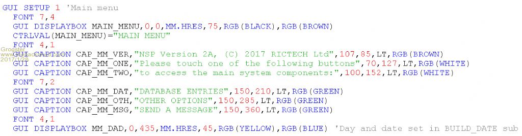

Posted: 08:24pm 06 Feb 2017
Further to Disco4now's example, here is my current MAIN LOOP - note that it is very short, and just checks flags and the serial port buffer, nothing else:
'MAIN LOOP:
START:
DO
If DEBUG then PRINT "Main menu."
CHECK_SETTINGS 'Check if any checkbox values have been changed
KEY=0:LCD_EXIT=0:LCD_OK=0:TEST_PASSWORD=0 'Clear flags
BUILD_DATE 'Construct the current date string
DATE_REF=VAL(MID$(DATE$,1,2)) 'Current date and time reference for main DO/LOOP
PAGE 1,6 'Main menu and buttons
GUI INTERRUPT MENU 'This interrupt will be called when there is an LCD touch
DO 'This loop detects any activity or other events while waiting for an LCD touch
If Val(MID$(DATE$,1,2))>DATE_REF then goto START 'If new day, then update the clock
If LOC(#2)<>0 then goto MSG_RXD 'Some kind of message was received.
LOOP until KEY<>0
Select Case KEY
CASE 1 'DATABASE - Get password before access
Goto GET_PASSWORD
Case 2
Goto OTHER_OPTIONS
Case 3
Goto MESSAGING
End Select
...and teh GUI interrupt for the above:
SUB MENU 'Main menu GUI interrupt
KEY=0 'Clear flag
Select Case Touch(REF)
Case BU_MENU1 'Button "1" touched
KEY=1
Case BU_MENU2 'Button "2" touched
KEY=2
Case BU_MENU3 'Button "3" touched
KEY=3
End Select
End SUB
In the first code-box, we setup the display of the controls, and then enter a loop that waits until a button is pressed, or something arrived on the serial port.
Assuming a button press, and assuming that is button "1", then the MENU interrupt is called, it is discovered that GUI button "1" is being touched, and so KEY is set to 1, and then the interrupt immediately exits back to the main loop.
At that point in time, the main loop sees that KEY is no longer zero, so it hops out of the loop, and is directed to another area of code based on the value of KEY - in this case, it will loop to the GET_PASSWORD chunk of code, and go about asking the user for the password.
The point I am trying to hammer-home here(as is disco4now and others), is that you only set a flag in the interrupt, and let the main code actually work out what has happened by checking the flags.
