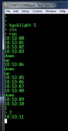

Now, when I run this, I get whats expected on the time_display_box object...
I touched a blank area of the screen to generate a few pen "down-up" events..
So far, so good...
Then I touch the yer_val_box and enter the new year data.. I hit the "Ent" button and get what I expect back into yer_val_box...

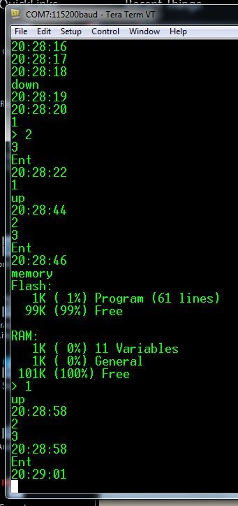

But then I notice the interrupts are no longer working...
Humm... Now, it took a few tries and head scratching, but, I finally noticed it..
In this "snip" pix, notice the "command prompt" ..
Yep, the program is still runing ok, but, the firmware has returned, and (not shown here), you can type commands and the firmware answers back, AND the yer_val_box is still active and working too..! However, the rest of the INT subs are no longer active... Not sure whats going on here..

Nope, acts the same way... Humm...
It shells out after I press the first key on the number entry pad...

Posted: 06:30pm 23 Jan 2017
I can repeat the error on a Explore64 with 5.3beta3
When I bring up the keypad I can move between the ALT and normal screens.
If I press on "CAN" caption gets the value of "Ent". That doesn't seem right.
After printing the value of caption, the program exits with the following error:
15:07:39
Ent
[35] Loop
Error: FOR with misplaced = or TO
There are NO FOR's in the program at all.
If I press a number on the keypad, the main program exits to the command prompt without any error message.
