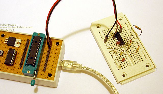

here is the setup used:
note the use of a 270k series resistor for the crystal, and 3M3 biasing resistor; i've read that one needs to be careful to not over-drive 32kHz watch crystals as it is quite easy to damage them.
