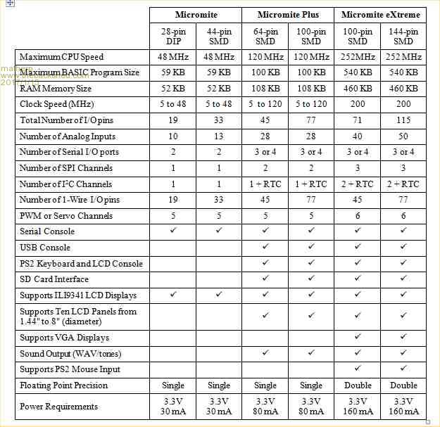

VERY simply:
MM2 28-PIN: For simple tasks, and entry-level stuff, and for initial learning about MMBASIC and teaching yourself the language and how to use it. Very cheap, and will run on batteries. Ideal for classroom experiments with it's DIL size. The only MM available in DIL package - all the other versions are QFP SMD packages.
MM+ 64-PIN: For more advanced tasks, most notably for anything requiring a MM automated GUI or SD-CARD use or any high-speed parallel LCD use.
MM+ 100-PIN: Same as above, but if you need more I/O pins.
MMX 144-PIN: The highest spec, fastest, most powerful version, with the most features and advantages of the entire series of MM chips(currently). Used when you need speed, features, GUI, SD-card, Touch, music playback etc ALL at the same time.
As I say - that is very simply, but hopefully will allow you to choose your chip a little more easily.
You do make a good point - now that there are several versions available, it can be confusing for newcomers, so I agree that another thread needs to be started to explain in more detail, the differences between them. "How to choose your Micromite chip" or something like that.

Peter, the matrix is exactly what has been needed (very well done), and I would suggest including this in each of Geoff's MM manuals. Showing the complete range up to the eXtreme even in the manual for the basic 48 MHz MM.

  Quote  Peter, the matrix is exactly what has been needed (very well done),
Not me, Geoff was the author, I just copied it from the Micromite eXtreme manual

  Grogster said  MM2 28-PIN: For simple tasks, and entry-level stuff, and for initial learning about MMBASIC and teaching yourself the language and how to use it. Very cheap, and will run on batteries. Ideal for classroom experiments with it's DIL size. The only MM available in DIL package - all the other versions are QFP SMD packages.
with 50k of RAM and 60k of flash available, i'd not be so quick to relegate the MX170 micromite's to a 'simple', 'entry-level' role. they represent an extremely capable micro-controller that is well suited to the vast majority of tasks, and may well outlast (and outsell) the bigger, faster, more power-hungry and expensive micromite variants.
look at the arduino ecosystem, where the 'old' 328p-based arduinos are far more prevalent and popular than the newer, more powerful offerings. this is why i was so keen on the E28 design, creating a cheap module that was easy for chinese clone-makers to copy.

Posted: 11:14am 15 Jan 2017
I would add the Maximites and the MX150 to the list.
They have all stopped at MMBasic V4.5 but still in use and a comparison between them and the newer offerings would help when thinking about an upgrade.

@ matherp/Geoff - excellent chart. I came across that in one of the latest downloads, but did not see it prior to making my post. This chart is way better then my attempt to explain things, as it shows EXACTLY what the differences are.

+1 for the chart from me too, thank you again Geoff and Peter.
I think a row in the chart showing the current version of MMBasic would be useful too, especially for the Maximite and MX150 versions. The versions for the MM2 and later ones could have an asterix to note: "still in active development; check Geoff's website for updates" or some-such.
Also the manuals that are relevant to each would be a handy addition, these have changed a fair bit - I mean mainly the name + necessary additions like the Hardware and Addendum manuals.

A table that includes board names (and any abbreviations) and CPU details would be useful.

The "spreadsheet" picture great. It looks like a spreadsheet or is it a table in in the PDF manual?
Is it possible to get a spreadsheet copy of this for download, then extra custom details can be added by the user.

here is a .ods spreadsheet of the data, with columns added for mono maximite and colour maximite. a note at end giving MX150 RAM and flash specs.
some details still need filling in, and i suspect the numbers for 1-wire pins for MZ2048 devices are wrong.
actual current consumptions for devices at different clock rates would be useful if anyone cares to perform a few measurements.

Just a note, as I have been compiling a list for the extreme 100 (I am looking at doing a MuP-ex100).
The extreme in the table above lists 71 IO pins.. From the table I have it `can' be 75 if PS2 k/b and Mouse is not required. So I suggest it be amended to 75.
For those interested here is the spreadsheet I have done for the 100pin extreme
