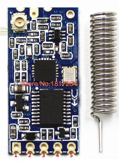

The HC-12 RF module like this one here:
...they come with little helicals so they are ready to use right out of the box, but does anyone know what frequency these antennas are wound for?
Usually, you can't have a frequency deviation of more then about 5MHz from what the helical is wound for, or the match will be horrible and you won't get the best performance from them.
In NZ, you are allowed -10dBW(100mW) in the 470MHZ SRD band, so I want to set the HC-12's for that frequency and run them full-power, but my concern is that the helicals will now be about 40MHz out, and the match will be terrible, subsequently the performance(read: range) will not be as good as it could be
I would prefer to use the 470MHz band, as not many things use it here, whereas the 433MHz band is quite active.
IF they are most likely 433MHz helicals, perhaps I can just cut a few turns off the top of them to tune them more to the 470MHz band? As I am moving up in frequency, cutting the antenna to match becomes a possibility. You can't do that if you need to cut it longer.
Comments?

I'm definitely not a radio guy Grog, but would this help at all?
Looks like 19 turns in your pic. haven't counted the ones I have here, but can do that & probably work out the unwound length of the wire.
Seems like stretching the coils would increase the gain; maybe?
Cheers.
Edit:-
Maybe someone like TassyJim can add some light to a few things?
IE is this uncoiled length of the helix a fraction for the wavelength?
433MHz=693mm. Is the length simply related to that?
Without taking any real measurements, I guess it's about 300mm stretched out.

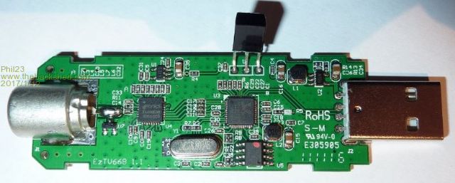

A few years back I played around with SDR using a Realtek RTL2832U DVB-T Tuner Dongle.
$15 from ebay. Covers a frequency range of 24 – 1766 MHz.
Just a matter of plugging it in & installing the software.

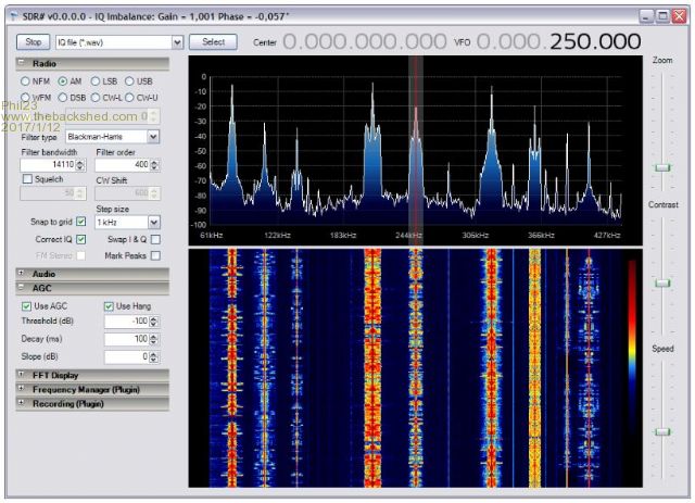

Silicon Chip had an article back in May 2013.
You can get outputs like this,
That are really helpful for seeing signal strengths of devices, an to also see what else is about on nearby frequencies that could be interfering with each other.
For the $15.00 it's a worthwhile tool to have.
Good resources in this site.

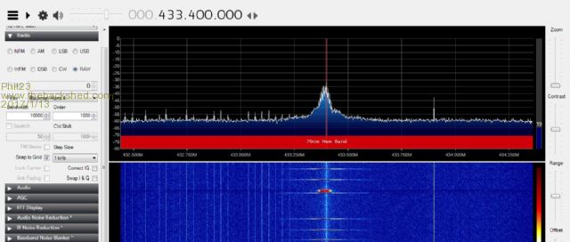

So I went & dug the USB tuner up a few minutes ago & plugged it into my laptop.
2 minute exercise to install the drivers & software.
This is what I'm seeing from my HC-12's using the approximately 4" whip antenna supplied.
That spike is the master polling the slaves; (master under a metre from me)
I can just see the slaves respond; (about 8m away).
As they are interrupt driven, their response is almost instantaneous, so easily lost on the spectrometer.
Could easily address that by giving them a 200ms pause for testing purposes.
It does peak a bit higher than seen above, just hard to get a screen capture.
Maybe for testing purposes a bit of code to continuously send data would be the go.
Phil.
