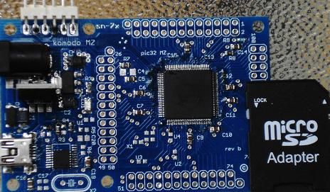

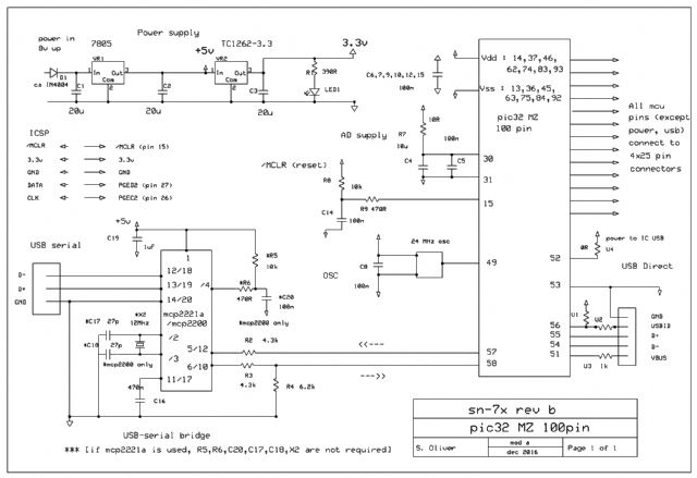

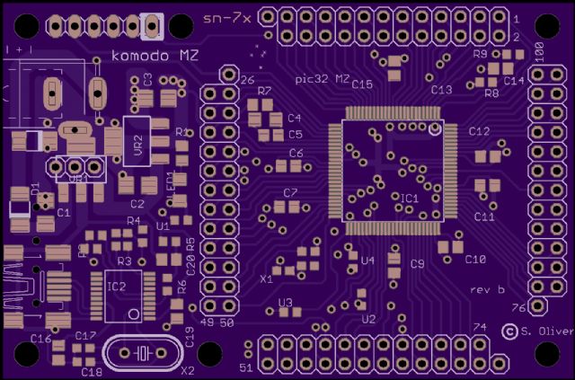

I have polished off the prototype so this is the "goer"
stage, it is a simple board that supplies a MZ EF (100 pins)
and its anciliaries, simple power supply for 12v operation,
and direct usb and also usb-serial bridge comms.
The prototype worked OK but using the pcb to dissipate a watt of heat
is probably always going to be marginal in aus conditions, so the
initial regulator has been changed to a old warhorse 7805 TO-220
so it can be bolted to a metal case etc. Also the 24 Mhz crystal is
dropped in favour of a silicon oscillator which can be left off if wanted.
Also the usb-serial bridge was a little dated so a mcp2221a can
now be used, which requires a lot less components around it
(no crystal needed) and installs automatically in win10. The pcb accommodates either.
A quick photo with a sd card size adapter for size comparison :
and a schematic

These pcbs can be panelised 2 to the 4x4" format so they are very
inexpensive in bulk.

Posted: 02:40am 31 Dec 2016
looks like a really nice clean design i assume the pinouts don't preclude running the "mmbasic-extreme" code that is currently being worked on by others?
might i offer a few suggestions:
1. retain the footprints for a standard 24MHz crystal and capacitors, as these may be much easier to obtain for some folks.
2. try to place the TO220 regulator at the edge of the board, so the body of the regulator can hang off the side and attach to a heatsink that is clear of the board. some users may also wish to wire in one of the cheap ebay china boost regulator boards, in which case a 3-pin header would likely be used.
3. allow 5v power to be derived from either USB connector (if this is not already possible). adding schottky diodes to steer the power should (in theory) introduce no real problems, or just have a jumper to select between the 3 possible 5v sources (7805, serial USB, direct USB).
4. place extra traces to the USB bridge chip so that a PIC16F1455 that runs peter mather's implementation of ascii ICSP firmware can be fitted. this entails just connecting up three more traces (PGD, PGD, MCLR) and providing a space to fit a 2-pin jumper or small momentary switch. this means the PIC32MZ can be programmed over the serial USB connection using pic32prog - no need to use a pickit2/3.
5. given the recent announcements, make a 144-pin version also available!
rob :-)Edited by robert.rozee 2017-01-01

>Who/what/where/when/price?
What do you think a fair price would be ?
(and is there a groat-to-greenback exchange rate ? )
The components would probably cost about au$25-30 retail
>extreme/crystal/reg/5v/traces
It uses 57/58 as tx/rx serial so it should be ok.
The prototype had provision for a crystal, I will bring it back
as an option.
The regulator leads can be folded 90deg so a shallow metal case can
act as the heatsink.
5v from usb would be a good option.
I considered at length the traces so a 1455 could be used where the 2221a
is. A three wire lead from the 1455 to the pickit3/icsp connector
would work, I would be able to put a pad next to the 1455 for the mclr
and the other two go to the i/o resistor pads.
BUT in general I think the pickit3 is excellent value and very effective,
and the MZ has two banks of flash so it is only a matter of time before
a self-programming via usb is implemented anyway, so it is mulling
at this stage.
144 pins ?? not likely..and the ELLO looks so good..then again the MZ DA is
supposed to be due.. arrrgh!...happy new year anyway!!!

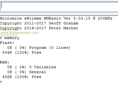

I tried it 1/1/2017, and I can confirm that the explore100 extreme software
does indeed install and runs the usb console prompt. So
the usb-client wiring and 24 MHz oscillator are good to go as well.
Edited by chronic 2017-01-04

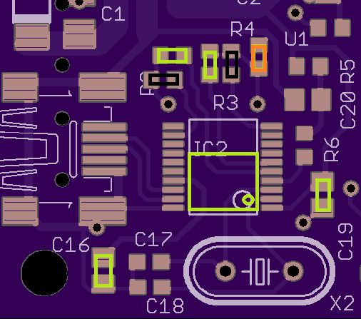

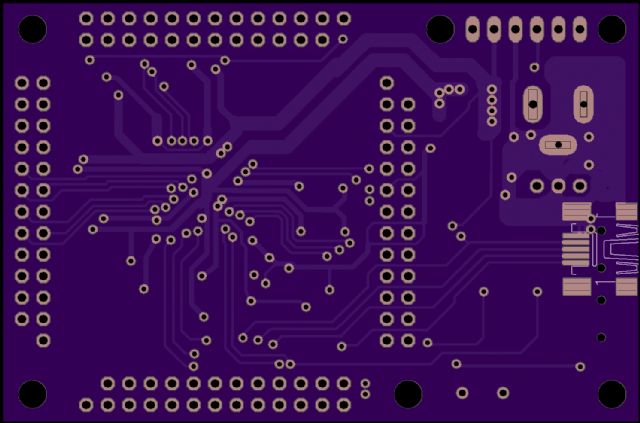

the pcb -
Posted: 07:05am 04 Jan 2017
Stuart,
A nice PCB layout there! What are the PCB dimensions in mm please?
WW
Posted: 07:14am 04 Jan 2017
Stuart,
I forgot to mention that I would like to offer to sell this PCB on micromite.org (assuming you are ok with that). Also part/full assembled modules for those unable to solder SMD.
Hopefully this will help give this nice MicroMite design more exposure beyond TBS.
WW
isochronic
Joined: 21/01/2012
Posts: 689
Posted: 12:21pm 04 Jan 2017
Thanks ! Dimensions are just under 50x75 mm,
I retain the copyright of course but apart from that, the design
is free for use up to the first 100, , I'll review
things at that stage. Go for it !

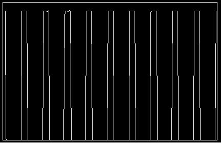

Posted: 06:21pm 09 Jan 2017
Using the MZ A-D converter - a quick trial, looking at the 32 kHz from a
RTC chip and displaying in TeraTerm -
It shows about ten cycles of 32 kHz, ie about a third of a millisecond,
using 256 points, which points to about 3 x 1000 x 256 = ca 750000
measurements/sec. (12 bits too..good stuff !!)
It is taking a short cut though , ie no USB. To synchronize with the USB
maintenance will be quite involved so that will have to wait for a while.
(ed)
The "zadacq" routine is just a loop getting measurements and loading the array
of 16-bit integers. The rest is initializing, screen, etc.
eg
PROGRAM sdistoburstMZ
INTEGER*2 dat(256)
CALL tekinit ( )
CALL tekrect ( )
CALL acquiredat ( dat )
CALL tekplot ( dat )
PRINT *,
END
SUBROUTINE acquiredat ( acdat )
ZADACQ acdat
RETURN
END
Edited by chronic 2017-01-29

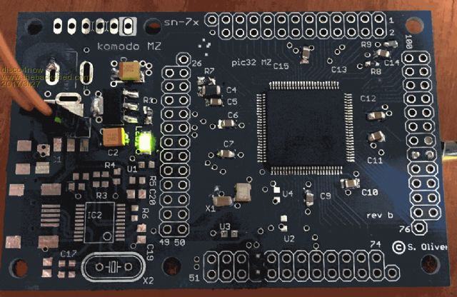

Posted: 02:43pm 28 Jan 2017
GDay Stu, All,
I can confirm these look a very nice board (I have 2 but yet to build them)
I think that this board could benefit from a daughter board to bring out suitable headers for various connectors, for example a 40 pin header for the 5"/7" displays and a 14pin for the SPI displays. As well as ps2 connectors etc.
Do you have plans for such a board? I am considering doing one for it but I do not want to step on your toes if you have plans for such a board..
As I have mentioned before I have been looking at a MuP 100 but I wasn't able to fit all I wanted into a 50 x 50 board ( I was over confident and too cocky I think .. It. Just will not fit ) .
What do you think Stu?

I have been asked if the usb-serial connection can use a pic1455
instead of a mcp2221a -
I *think* the mcp2221a is based on a pic16f1455 or very similar,
with proprietary microchip code running on it. The price is very similar.
