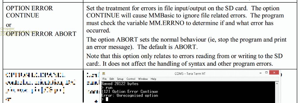

Hi folks.
Trying to simply issue Option Error Continue at the top of my code, but MMBASIC rejects it as not valid:
Manual says it should work - what gives?
Have tried this with and without all caps - makes no difference and is rejected.
I will comment-out this line for now.Edited by Grogster 2016-12-26

Grogster, I believe On Error continue may have been replaced with the On Error Skip (etc) format.
I use the following method now extensively in code using SDcard calls plus for any other sensitive areas that could cause the program to halt and where watchdog resets are too inelegant. I would prefer to have a more universal error trap system but this is all we currently have.

I then have a Function call that evaluates the err and can take further action if required within the function etc (here I am also returning the error via a wifi network) but usually I just make an orderly exit so i can close open files etc.

Awesome, thanks.
I did not know that - although, OPTION ERROR CONTINUE is still listed in the manual.....
In any event, ON ERROR SKIP is probably more useful, so I will work on that premise.
