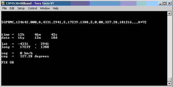

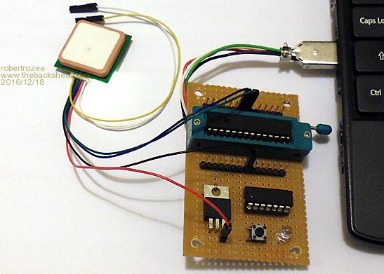

hi,
below is a small demo showing how to achieve the following:
1. configure a SiRF chipset to output a single NMEA sentence repeatedly
2. implement serial input using an interrupt, data saved in a circular line buffer
3. use VT100 codes to clear screen and position cursor
4. extract comma delimited data from a string
NMEA sentences from the GPS are terminated with CR+LF, and this pair is used to split up the data stream into individual lines. up 9 lines can be held in the circular line buffer before it overflows.
the SiRF chipset can be configured with static navigation on or off. when turned on, static navigation attempts to eliminate 'wandering' causing the appearance of false motion. in general, it does this poorly, and so by default the below code turns static navigation off. the SiRF3 default is for it to be turned on.
rob :-)

If Instr(B$,"$GPRMC")=1 Then ' check if sentence is the one we want
Print at$(1,4); B$; clreol$
Print clreol$
For I = 1 To 16 ' extract parameters one at a time
J = Instr(B$,",")
If J=0 Then Exit For
B$ = Mid$(B$,J+1) '$GPxxx is first discarded (param 0)
If I=1 Then GPS.time = Val(B$)
If I=2 Then GPS.OK = (Left$(B$,1)="A")
If I=3 Then
K = Instr(B$,".")
IP% = Val(Left$(B$,K-1))
FP% = Val(Mid$(B$,K+1))
GPS.lat% = IP%*10000+FP% ' 1/10000th of a degree per count
If (I=4) And (Left$(B$,1)="S") Then GPS.lat% = -GPS.lat%
If I=5 Then
K = Instr(B$,".")
GPS.long% = IP%*10000+FP% ' 1/10000th of a degree per count
If (I=6) And (Left$(B$,1)="W") Then GPS.long% = -GPS.long%
If I=7 Then GPS.sog = Val(B$)*1.852 ' convert knots to km/h
If I=8 Then GPS.cog = Val(B$)
If I=9 Then GPS.date = Val(B$)
Next I
time.H = GPS.time \ 10000
time.M = (GPS.time \ 100) Mod 100
time.S = GPS.time Mod 100
date.D = GPS.date \ 10000
date.M = (GPS.date \ 100) Mod 100
date.Y = GPS.date Mod 100
Print at$(1,8);
Print "time = ",
Print Str$(time.H,2,0," "); "h",
Print Str$(time.M,2,0,"0"); "m",
Print Str$(time.S,2,0,"0"); "s"
Print "date = ",
Print Str$(date.Y,2,0,"0"); "y",
Print Str$(date.M,0,0,"0"); "m",
Print Str$(date.D,0,0,"0"); "d"
Print
Print "lat = ", GPS.lat% \ 10000, ". "; Abs(GPS.lat% Mod 10000)
Print "long = ", GPS.long% \ 10000, ". "; Abs(GPS.long% Mod 10000)
Print
Print "sog = ", GPS.sog; " km/h"; clreol$
Print "cog = ", GPS.cog; " degrees"; clreol$
Print
If GPS.OK Then Print "FIX OK";
Print clreol$;
B$ = ""
End ' end of program
