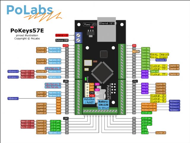

PoLabs is a european company which makes small affordable controllers -
They are used for Homeautomation CNC-Control etc...
I did not use them yet, but their users seem to be quite happy with them
They are quite versatile driving Steppers, reading encoders and many other type of sensors in realtime (CNC Machines do not tolerate lost pulses...)
You have a graphical programming environment - Poblocks
Either USB HID Interface or Ethernet & WEB Dashboard, Modbus TCP etc..
It should be possible to interface by I2C to the Micromite
Price is around 50 Euro
Pokey Ethernet Version
POblocks example
Features:
Ethernet 10/100 with DHCP client or fixed IP support
TCP connection with device
55 digital inputs with pull-up resistors
55 software controlled digital outputs
7 analog inputs (12-bit) with adjustable low-pass filtering support
Up to 26 encoder pair inputs (3 high-speed encoder inputs, 1 ultra high speed encoder input)
3-axis 25 kHz or 8-axis 125 kHz Pulse engine
Digital counters on specific digital input pins
Up to 16×8 matrix keyboard
Two 8×8 matrix LED display support
Up to 6 high-speed fully configurable PWM outputs support (25 MHz PWM timer)
HD44780-based character LCD support (up to 4×20 characters)
PoExtBus support for adding up to 10 external shift registers = 80 aditional outputs
PoNET devices support (48-key CNC keyboard, etc…)
Modbus TCP support (access to digital IO, analog inputs, encoders’ counters, digital counters values, PWM outputs, LCD display, LED matrix display, PoExtBus devices, matrix keyboard status)
Support for up to 10 sensors on I2C bus, up to 10 sensors on 1-wire bus and up to 7 analog sensors
Web interface with newly designed dashboard and I/O status display with multiple user accounts
Support for communication with devices on I2C and 1-wire buses
Support for Connection signal output
Intuitive and user-friendly software
Third-party support via communication DLL library and extensive protocol specification document that allows porting to other systems
Plugin for Mach3 and Mach4 software, PoKeys as 4-axis external motion controller or general purpose, highly cusomizable Human Machine Interface
PoBlocks graphical programming PLC software
