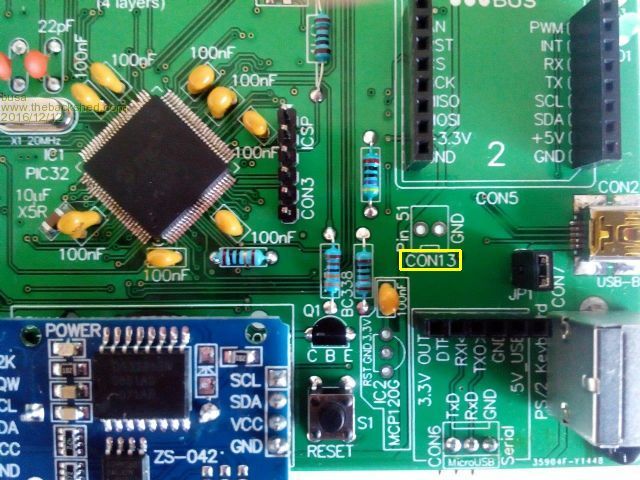

Hi all, I have just received my explore 100 kit. Can anyone tell me what Con13 is for and what it does exactly. Am i supposed to have a jumper on there. Look forward to an answer.

That looks like con13 just to the right of centre unless I am reading it wrong
Posted: 09:45pm 11 Dec 2016
It is just breaking out Pin 51 (and Gnd). NOTE: Pin 51 is an INPUT only!
No, you are reading it right, but this is not my board, it must be the Silicon Chip board. No jumper required. It is simply the spare "Pin-51" of the chip, and a ground reference. Pin-51 was not assigned to anything, so it was routed out in case someone wanted it for something. This pin is DIGITAL INPUT ONLY.

I just checked my version 1C board from Silicon Chip and it shows exactly as your image. It took me a while to see it so I've put the image up again with a yellow highlight. I'll have a read of the articles and see if I can find it. Unfortunately I don't have the electronic Sil Chip else I could search for it. It looks like it is to ground pin 51.

NOTE: CON13 (as labelled on the SC PCBs) is NOT a jumper. It has thrown me a few times when assembling PCBs for customers as it is very close to the USB jumper (JP1) which needs to be in place if powering from USB (CON2).
I believe there was no space on the 40-way I/O header, so being an input pin only, it was relegated to its own header so at least it was available to anyone wanting it. Next to a GND pin which makes a useful two-wire switch type input.
WWEdited by WhiteWizzard 2016-12-13
Posted: 10:36pm 11 Dec 2016
It is a ground REFERENCE for Pin-51. Being that this pin is input only, you could put a jumper on it if you wanted to - it would do no harm as this pin can never be an output.
