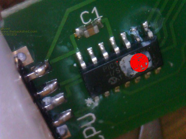

I think Forum here is just the right place to get a helping hand to learn about a USB protocol connection problem.
Background
I bought a small gas analyser based on the MQ-3, multi gas sensor. We have had it for about 10 days. Very simple gas, flows past a heated sensor resistance, a PIC16F1455 i/SL measures the voltage change accross a resistive divider. The result is shown in 'morse code' on green, red, yellow LED. The operator writes the interpreted figure in a book.
For those interested in spreadsheets/graphing a PC can be connected via USB port and a program does whatever is needed, etc. In this case a Toshiba Tecra R940 running Win 7 32 bit.
After a couple of days getting use to the unit, including calibration and initialisation procedures, we noticed for no reason the message from the program driving the data collection would come up with "device unplugged".
It was one of those situations where, connecting cable, sockets, and because it is a very new product the software also fair suspect.
Present situation
Breakthrough of a sort yesterday, finally the program could no longer connect the unit and Windows declares that device connected unknown. Unit still works in stand alone mode driven by a battery or from the USB power but result must be recorded via 'morse code'.

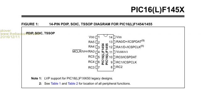

The PIC16F1455 i/SL is physically connected directly via pin 12 and 13. This assumed from visual inspection. I am yet to try and make measurements, I should be able to connect my Oscilloscope when running on the battery.
My question what happens when a pic micro (assuming it is programmed properly) is connected to a laptop USB port?
Since the laptop does not recognise the device any longer, something that should happen does not?
I will see if I can attach a picture of the micro and some tracks. I used Image Upload and it seems to have gone. Yes I can see it in preview.
For most of you chaps it is probably self evident how the USB is connected. Though it is an assumption that pin 12 and 13 is used based on few pictures I saw on the internet.

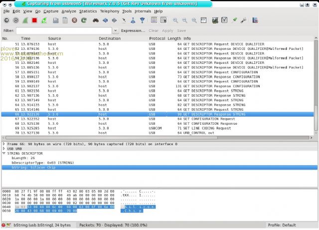

I should mention I can partly monitor USB traffic/messages on the port USB ports with Wireshark but again I don't know what messages goes back and forth when connecting the device, just when I was ready it crashed completely. Took some time to get a form of Wireshark running and when I understood the operation of Wireshark it was too late so far.

Can now confirm that USB D+/D- have continuity to the pic pins 12 and 13.
Tested another cable, same result as proprietary cable, USB port not responding
For the linux minded, plugged unit in and tested lsusb in a terminal, no port connection (I feel a bit more comfortable in Linux)
Have downloaded the pic16F145X Data Sheet (418 pages food for the weekend) and flipped to section 26 USB, interesting stuff here which I can follow in theory but in practice I am stuffed at the moment. Did figure out that USB can be configured on pin 12 and 13. (Of course makes sense as the device have worked for over a week many hours a day, minor outages on and off until permanent crash)
There is also something about termination resistors need to be programmed in, but exactly how this can be tested in practice is not clear. Assuming USB programming is done and the device is powered on only, D+/D- not connected what voltage level can be expected. Looks like a good time for making a USB breakout box too.

I have a fully built Maximite Colour system, I was reminded here in forum that these of course come with USB connection. At this stage it is all I want to know. Promptly finding a USB cable -A-B and plugin into Linux and doing: "dmesg |grep usb"
[ 0.000000] usb 5-1: New USB device found, idVendor=04d8, idProduct=fd52
[ 0.000000] usb 5-1: New USB device strings: Mfr=1, Product=2, SerialNumber=0
[ 0.000000] usb 5-1: Product: Maximite
[ 0.000000] usb 5-1: Manufacturer: Silicon Chip
[ 0.000000] usb 5-1: USB disconnect, device number 2
[ 0.000000] usb 5-1: new full-speed USB device number 3 using uhci_hcd
[gert@kde64byTexstar ~]$
Even better I hav Wireshark running here on Linux too:
I was looking for something like that, I consider the Maximite similar to the gas analyser in this initial phase of setting up. Maximite gave me swag of commands from the USB protocol, these are a bit heavy duty to decipher but the gist of operation can be had.
In this case I also had the filtered USB output from dmesg in Linux so in my mind that pretty well nails it. If the analyser PIC 16F1455 -I/SL was working properly I should have seen something similar. This I can take back to the manufacurer.
Summing up: Mechanically up to pin 12 and 13 the analyser seems sound, USB connected to this 'port' and the PIC seems to work messaging via the LEDs. Appears USB protocol no longer working or configured correctly.

When the Maximite is plugged into a USB port and just sitting idle. D+= 0.0V and D-=3.0V when nothing plugged into the port the voltage from the PC on the D lines is both 0V.
When I plug my gas analyser in to the same port the expected 3.0V on the D- line does not show. A varying floating DC voltage, from minimum about 200 mV to a maximum of 900 mV.
Wonder if it is the attempt to get up to 3.0V, like a pull down resistor missing (if such is needed). Too late tonight, I will read a bit about the USB port configuration and implementation before trying any more experiments.

This problem got more and more odd until it finally started to fall into place. When I got the oscilloscope on the breakout board I had made up for the USB. The power never played up or I have not noticed.
Looking at the USB D+/D- lines, there was odd behaviour, could not get consistent results repeating the same test. When I found out that two USB cables I use regularly would fail on the analyser that was the turning point.
I started moving the cable connection about carefully making sure powered never flinched but the oscilloscope on the D lines started misbehaving, it was apparent that the D- line was not making contact, tempted to say it was arching.
Turns out that the custom supplied cable, plus two of my cables when pushed on to the plug socket fully home would fail but if withdrawn approx 1 mm they will work. Another shorter USB cable I have did not have that problem.
The Analyser has been used for several hours and working fine, just a few minutes ago "device disconnected" showed and was easily fixed my slightly pulling back on the cable. It is hardly worth the trouble replacing the plug at this stage, seems easier to insert a small gasket like cardboard piece preventing pushing too far.
I will go back to the supplier and suggest they send me two new plugs tested to work.
I tried to use my USB micro scope to look inside the plug but I do not have good field of depth. I did think I could see something that looked like corrosion on the D- contact but really not conclusive, even a cleaning attempt did not change the picture a lot.
It took me an inordinate amount of time but I am satisfied that I now what the problem is. Part of the time I can write off as a crash course in USB port design and operation. I even managed towrk out from the D+/D- line operation that the analyser was running a USB 1.1 or fullspeed later confirmed when I could see the enumeration when connecting to my linux system.

Post Script:
After a couple of times giving "device unplugged" I got the micro scope out diligently took some more photos from inside the plug as best I could. It seemed there was somthing like corrosion on the D- finger.
I tried to carefully scrape with a small scalpel, toothpick was not effective. The finger appeared cleared of what ever it was. For the moment it seems to be working fine, no need to pull connector back 1 mm or so to keep it working.
This is a weird problem.
For my record, above still did not last more than a couple of days. Inspection of the male USB plug does not seem to reveal the problem. So the last try is bypassing the USB plug by soldering in 4 wires connected to a plug and breakout board if oscilloscope measurements needed.
A tedious delicate job to try and solder in the wires with shaky hands. Got them in place and the operation seems much more robust. I must get a couple of USB A surface mount male plugs and replace the existing one.
