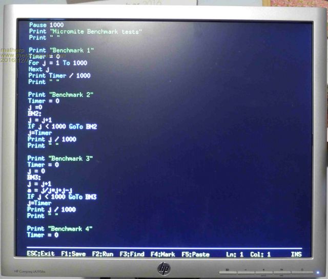

This release includes full 640x480 VGA capability for both the 64 and 100-pin MZ parts. Note this requires a 24-MHz oscillator and going forward I will only be supporting 24-MHz oscillators for the EXTREME as these give full 200MHz capability. If you have a PCB with a 12MHz oscillator these can be easily swapped with a heat gun. I used RS part number 667-6338.
2016-12-07_155919_MicromiteEXTREMEb5v6.zip
use:
OPTION LCDPANEL VGA
to enable the display, then
OPTION LCDPANEL CONSOLE 1
will give a 80x36 line display for the console with full colour editing capability.
All Micromite-PLUS drawing and GUI commands are available as per a TFT display

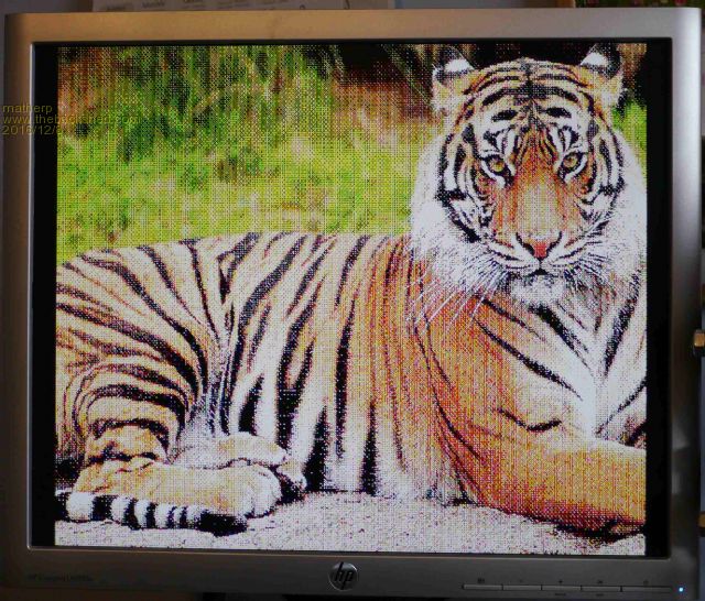

Attached is a photo of our friendly tiger converted to RGB111 using XnView set to do 8-colour Bayer dithering displayed using the VGA driver. Loading the image takes just under 1 second.
2016-12-08_114326_tiger640.zip

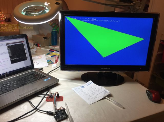

Posted: 03:27am 08 Dec 2016
Hi Peter,
Getting closer to testing.
Currently have the 24MHz swapped onto the PCB (i.e. replaced the 12MHz oscillator) and have the Beta successfully loaded and running.
About to build the video circuit but can't find any spare diodes so need to pull them from something.
Couple of questions:
1> Your comment in the above post about '... lose SPI2 which means no SDcard' only refers to IF you want to use I2C on the 64pinner - correct? I am currently just wanting VGA and SD on kiiids nice little PCB. The SD card does use pin 12 for SD CS so I will alter this to allow VGASync on pin 12.
2> Is there a 'limit' to the length of the VGA. I have a 3m and a 5m one, none shorter unless I pop out and buy one. Do you think a 3m VGA lead between MM and monitor will work ok?
Love the 'dithered' Tiger - hope to see it here later on my monitor once I've built the VGA circuit, and sorted an appropriate vga lead.
Will update later . . .
Posted: 03:48am 08 Dec 2016
On kiiids PCB, I have cut Pin12 track going to SD CS, and used MM pin 32 as the SD CS.
VGA option and SD card working fine together - another step nearer
Now to rip out some diodes from something so I can complete the VGA circuit.
Posted: 06:40am 08 Dec 2016
SUCCESS
Few things to feedback:
1> I had a loss of the RED signal which I assumed was a loose wire. However, nothing was obviously 'broken' so did a reset and I had the 'RED signal back! Not been able to re-create this, but will keep an eye out for this one.
2> The Triangle command is fantastic. However, can I suggest an extra parameter to match the other command (such as BOX, circle, etc) in that there is a 'line width' parameter.
3> (One for Geoff maybe). I use the OPTION LCDPANEL CONSOLE 1,RGB(...),RGB(...) to set the default colours of the console. Upon a power-up, or a reset, the screen is cleared to black rather than the background colour set in the OPTION LCDPANEL CONSOLE command. Note that any text drawn (such as the welcome message upon power up) is correctly drawn with the foreground/background colours; however, as I mentioned, the rest of the screen is black.
The GUI TEST LCDPANEL draws the circles amazingly quick
Will keep testing . . .
WW
Posted: 07:54am 08 Dec 2016
Peter,
If you draw a triangle with lets say a red 'outline' and a green fill and on a black background; then draw another triangle with all the same 'co-ordinates' but this time with a black 'outline' and a black fill, then I would expect the triangle to 'disappear.
However, most of the red outline remains on the screen.
Have not tried combination of other colours (for outline, fill, or background) but hopefully this is enough information to fix the issue.
It was discovered whilst doing a speed test to draw random triangles on the screen; but instead of using CLS to clear the screen, I 'over drew' the triangle in the 'background' colour to make it 'disappear' (but it didn't).
Hope this all makes sense . . . .

Posted: 08:49am 08 Dec 2016
  Quote  On kiiids PCB, I have cut Pin12 track going to SD CS,
Pity I didn't see this before I could have made that one line user selectable as part of the OPTION LCDPANEL command. I'll do that anyway in the next release.
  Quote  However, can I suggest an extra parameter to match the other command (such as BOX, circle, etc) in that there is a 'line width' parameter.
You will notice that the current LINE command doesn't support the line width parameter for diagonal lines. For the same reason it isn't doable for triangles which are comprised of a set of diagonals.
  Quote  If you draw a triangle with lets say a red 'outline' and a green fill and on a black background; then draw another triangle with all the same 'co-ordinates' but this time with a black 'outline' and a black fill, then I would expect the triangle to 'disappear.
This is an issue Geoff has already picked up on. I'll post a fix in the next beta.

  Quote  7> Now look at the MEMORY command as it was typed and it has cropped the last row of PIXELS
This could be your screen not displaying the full 480 lines. My "old" 1280x1024 screen works perfectly - rock solid picture no missing lines. My "good" Dell screen gives a less stable image and the position is one line off.
In the next release I will include a fudge factor to allow the vertical position to be adjusted.
Try BOX 0,0,640,480 to see if you can see the complete outline

The 'cropped pixel' issue I think may have been misunderstood. What I observe is the missing pixel row being 'scrolled up' the screen. The lower part of the letter 'y' within the word 'memory' IS displayed when it is typed on the last line of the screen. However, when I hit 'Return' to perform the Memory command (i.e. to display the information) the screen has to scroll up to be able to show the information. When the word 'Memory' is observed (which is now a few lines up from the bottom of the screen), the bottom row of pixels of the letter 'y' is missing.
On the note of screen position: I had to adjust the position and size of the whole image on my monitor so that the extremities were visible. Even with the 'auto just' option on my monitor, I still had to manually adjust. I will try more monitors tomorrow to see if this is something that may be of a concern.
Will continue to do more testing . . .

  Quote  When the word 'Memory' is observed (which is now a few lines up from the bottom of the screen), the bottom row of pixels of the letter 'y' is missing.
OK I understand - found and fixed
