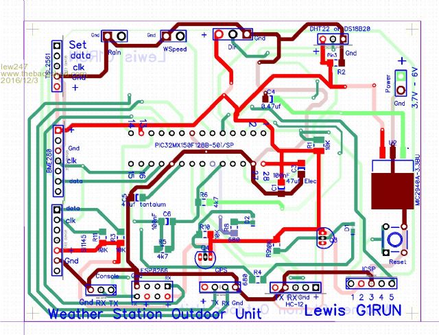

I decided to make 2 boards
1: an outdoor board to connect with an anemometer, direction gauge, rain gauge (tipping bucket type) BME280 Temperature, pressure and Humidity sensor and a HC-12 to communicate with the indoor unit
It also has a GPS interface, mainly to set the clock on the indoor unit and not have to worry about the time being wrong when BST/GMT/DST time changes happen, as it does it all and only sends the correct local time once every day at 02:01 and when it is first powered up.
The anemometer can be any cheap or expensive one, mine has 3 switches for each 360° rotation
The code tells you how to work out how to use any anemometer.
The direction control is a simple wind gauge connected to a 360° variable resistor (pot)
This one has no end stop, and the direction is worked out simply by measuring the resistance.
The rain gauge is a tipping bucket one – I used a Maplin one because I saw it on Ebay cheap, but any can be made and you can find instructions for making them online – details of changes to use other ones are in the code.
I’m quite happy with the outdoor code, I’ve had it working for a few months just going to a console output so I can monitor it.
It sends the following to the Indoor unit every 3 minutes at the moment, although I may change this to every 3 minutes during daylight hours and 15 minutes at night
(OR anyone can change any of the code if they can do it better or see changed that will be useful)

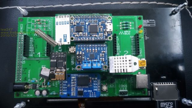

The indoor unit is much harder
I started off with a board I made myself to fit on the back of a 7” ssd1963 display but after about 6 or 7 boards I gave up
I kept making silly little mistakes on the circuit layout and a lot of these where getting the txd and rxd from the communication modules wrong – a result of my brain not being able to get it right!
In the end I started again with a new design that connects to the 40 pin header on the E100 board.
This leaves the 2 mikro board spaces free for other use.

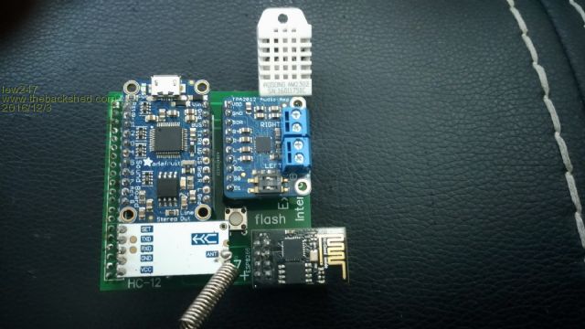

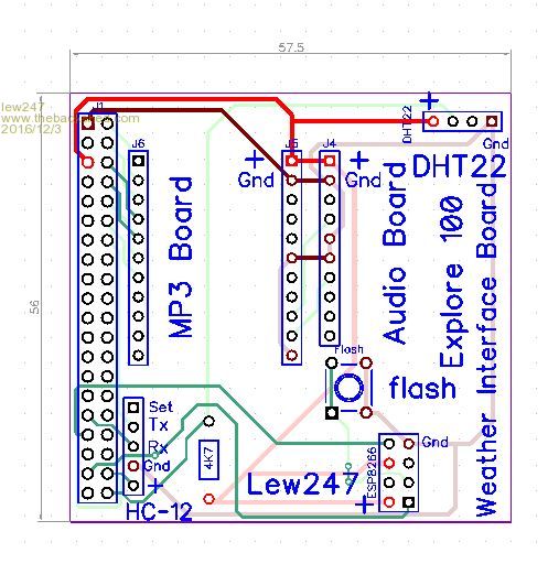

The board has the following on it.
40 pin connector to connect to the E100
5 pin socket for a HC-12 TX/RX unit to communicate with the outdoor unit
2 X 11 pin sockets where an Adafruit 2133 Audi FX board plugs in
1 X 10 pin socket where an Adafruit 1522 2.1W Audio amplifier board
1 pushbutton (used for flashing the ESP8266)
1 4k7 resistor
1 8 pin socket (esp8266)
1 ESP8266 wifi (with EspBasic installed)
1 DHT22 Temp/Humidity module
The audio board is so when the display is finished, the Big Ben clock used on the display will actually chime the ¼ ½ ¾ and hour chimes and it has the hour “gong” on it as well

The ESP 8266 collects todays weather and the weather for the next 3 days
I got it to collect todays as well in case Anyone wanted to just use the Indoor board WITHOUT having their own weather station sensors outside
The HC-12 communicates with the outdoor unit and receives the following ready to display
Day/date, time, temperature, pressure, humidity, wind heading in degrees, windspeed in MPH (easily changed to Kph if wanted) Wind gust, highest wind gust, mm rain, mm rain yesterday, highest temperature since 06:00 Highest temp yesterday, lowest temp since 06:00, lowest temp yesterday, UV index and battery voltage

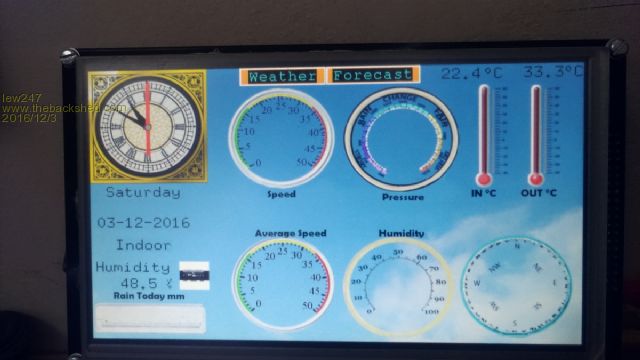

AT THE MOMENT the code for the indoor unit only shows the clock, indoor temp and humidity

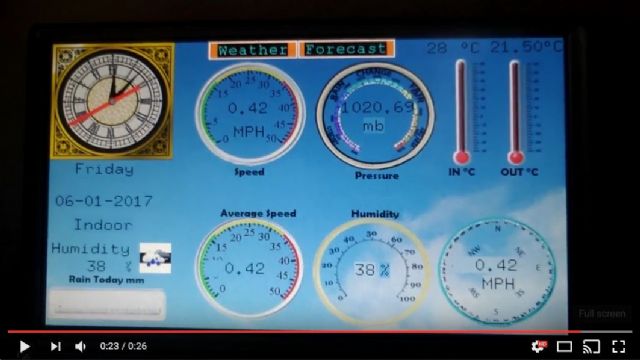

It has “gauges” (pictures) to show the Wind speed, Pressure, Average Speed, Humidity and Wind direction.
THIS DOES NOT WORK AT THE MOMENT AS I CAN’T FIGURE OUT HOW TO GET THE GAUGES WORKING – I’M NOT good enough with coding!!!
Ideally I’d love the gauges to be written with software and not use the “bad” pictures I’m using at the moment
It also shows the correct weather icon for "today" and the indoor and outdoor "top right of the display" very dirty code but just to show it working.
It’s set up so that if the screen is pressed it will go to “Page 2” (this did work fine with my board, but for some reason the touch doesn't work now - to be investigated later)
Page 2 is set up to show the screen split into 3 sections
Tomorrow, the day after and the day after that too and it gets the information from the ESP8266 on COM 2

The parts list for the outdoor unit is:
Micromite 28 pin
3.3V regulator I used MIC2940A-3.3BU but any with the same pinout and around 1A will do (the circuit uses a lot less than 1A but I prefer to have a vreg that won't get hot in use which is why I use this one)
BME 280 sensor
SI1145 sensor
GPS unit (9600 baud)
2 x sms led's
1 X 47uf Elec cap 1206
1 X 47uF tant cap 1205
1 X 0.47uf cap 1206
2 X 100nF cap 1206
1 X HDT22 OR DS18B20 (I used a DHT22 although you don't need this as the BME280 already measures these)
2 X 2n3906 transistors
5 X 10K res 1206
1 X 10K res 1210
3 X 4K7 res 1206
2 X 680 ohm res 1206
Reset switch B3F-100 (or similar)
1 X 28 pin dil socket for the micromite
1 X 5 pin socket 2.54mm pin spacing
1 X 7 pin socket 2.54mm pin spacing
2 X 4 pin socket 2.54mm pin spacing
1 x 3 pin pin socket 2.54mm pin spacing
1 X 5 PIN header pins 2.54mm pin spacing (icsp pins)
3 X 2 pin screw terminals 3.50mm in spacing
1 X 1 pin screw terminal 3.50mm in spacing

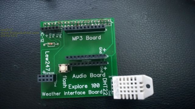

Posted: 01:48am 06 Dec 2016
The Explore 100 board just has one 4K7 resistor (normal sized NOT surface mount) and 1 ESP8266 module programmed with ESPBasic to make it work as a weather station
It doesn't "need" the outdoor board to have a weather station with this, it pulls the weather off the internet every few minutes to update the display
You can have it updating every 15 seconds if you want
The rest of the components are just header sockets.

lew247
Joined: 23/12/2015
Posts: 1709
Posted: 02:26am 06 Jan 2017
Update on the progress
YouTube Link
As you can see it looks pretty "s*it" at the moment, when it's finished I want to get rid of the pictures for speed, pressure humidity and wind direction and replace them with a proper code written circle with a proper dial that moves
Unfortunately I am not skilled enough to do this - any volunteers?
It only updates the weather every 30 seconds so the dial won't need to move other than twice a minute.
I still haven't done anything about displaying the temp as graphs, or the rainfall
I'm open to other suggestions as to how the display should look, ideally I'd like to keep the clock if possible though
Page 2 as you can see if the weather forecast for tomorrow, the day after tomorrow and day 3
Again it looks pretty rubbish but I am new to all this so it's the best I can get it at the moment
It gets the forecast from the internet by communicating with an ESP8266-01 loaded with ESP Basic, dead simple to program
