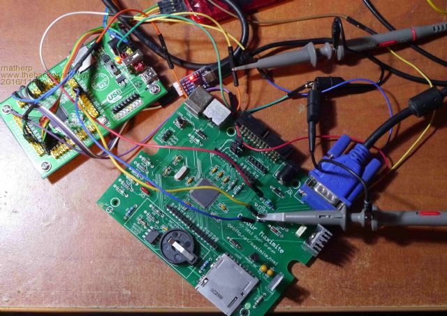

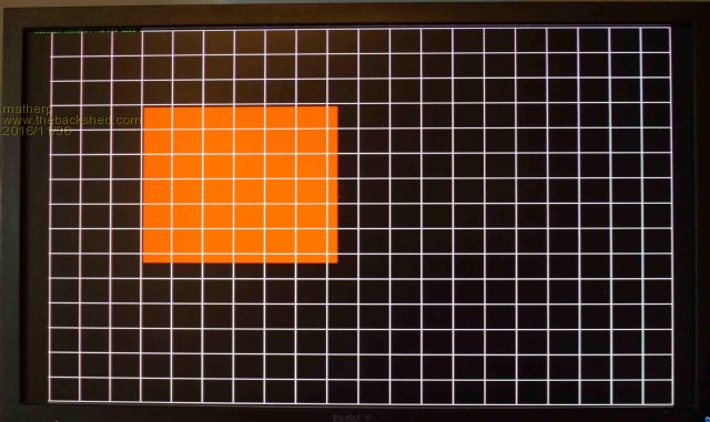

Using an unpowered Maximite to provide the VGA physical connection and diode clamping.
Picture is stable and clear full 640x480 resolution (8-colour)
Lot of work still to integrate and still a few funnies (green line at top left of image)

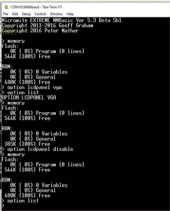

OPTION LCDPANEL VGA
after that it will be able to be used transparently in exactly the same way as a SSD1963 or ILI9341 display so all the graphics commands should work. The only difference is that VGA is only 8-colour. The code uses a frame buffer in the MZ memory but that only reduces the user available RAM by about 100K (from 470K). When the VGA driver isn't loaded then there will be no impact on memory or available pins.

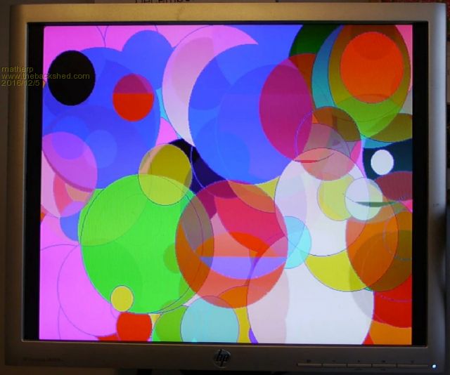

Demo video
Posted: 06:45am 05 Dec 2016
WOW - that is FAST!
Is that a 'hacked' GUI TEST, or have you got several/all the general graphics interface working with the MM firmware?
Posted: 07:05am 05 Dec 2016
  Quote  have you got several/all the general graphics interface working with the MM firmware?
Yes - everything working except the console - that is next on the to-do list.

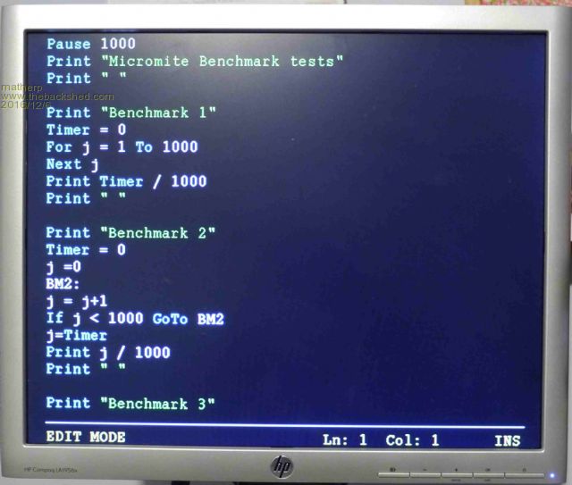

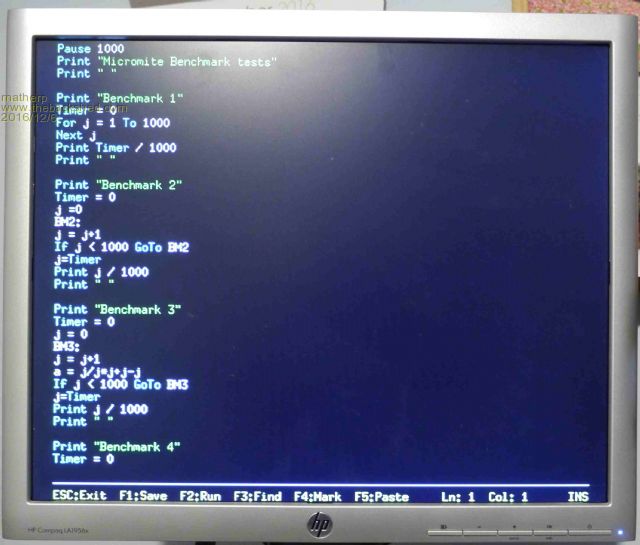

IF Load Image is also working- ow does it deal with converting RGB to the limited number of colours? Or put another way, will it still load a .bmp if you create the .bmp file in the 8 'correct' colours?
I assume this is still 640x480? What size characters are you thinking of using for the editor? i.e. how many columns & rows do you think is achievable to make a nice readable Editor display?
