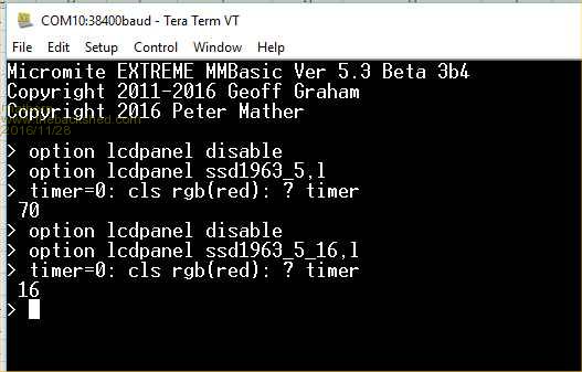

This release implements the new pinout for the 100-pin MZ and also includes 16-bit versions for all the variants of the SSD1963 displays. To use the 16-bit driver just add "_16" to the display type in the OPTION command as per the screen shot. The 16-bit drivers are not available on the 64-pin parts.
The advantage is the driver is MUCH faster. The disadvantage is that it uses more pins and is RGB565 rather than RGB888. The display pins DB8-DB15 are connected to pins B8-B15 in the list below.

Subject to any bug fixes this completes the port of MMBasic 5.3b3 and includes the key functionality I wanted to achieve to allow operation at much higher speed (CPU and display) and greater accuracy (double precision floating point). I'm open to suggestions for enhancements but these should be things that specifically take advantage of the high performance platform rather than things which Geoff may or may not choose to include in the MX470. In general my intent is that the code will stay completely compatible with the MX470. i.e. anything which runs on the MX470 will also run on the MZ with no changes (other than pin allocations).
The above test was run on a Snadpic MZ board but note the Snadpic regulators are not capable of powering a 5" or 7" display properly so I'm using an external 3.3V supply connected direct to the display with a common ground.
