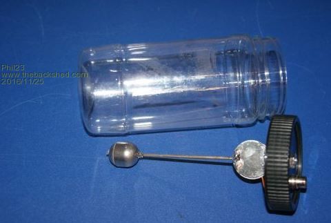

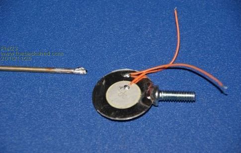

Food for thought regarding an easily built sensor...
Pretty self explanatory.
Phil.

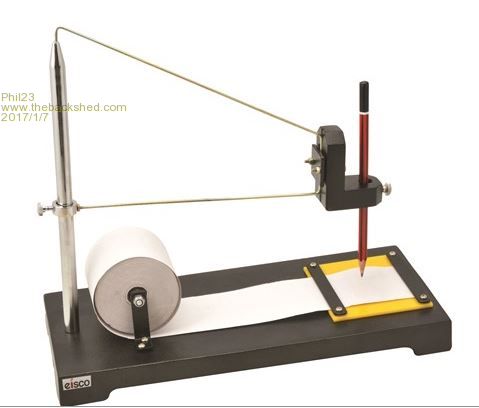

Posted: 04:54pm 06 Jan 2017
Still got this idea ticking away in the back of my mind.
Any thoughts on adding a sensor to this?
$116AUD.
Here and here.

Posted: 04:57pm 07 Jan 2017
The circuit in the original SC article is simple enough. Just replace the PICAXE with a 'mite of choice and a display.
The signals of interest are low frequency so the mite's analogue inputs will be plenty fast enough.
The 3 axis accelerometer should also work but I am not sure about their low frequency abilities.
It would be interesting to compare the sensitivity of the two methods.
It is something I nearly built when the article came out and next time the earth moves, I will wish I had.
Posted: 05:17pm 07 Jan 2017
I should have added that it is the movement of the earth we are looking at, not the pendulum so the 3 axis accelerometer is simply glued to a convenient lump of concrete.
That makes the hardware side of things easy!
