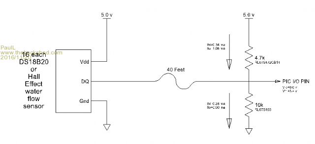

I need to interface 14 DS18B20 temperature sensors and 2 Hall effect water flow sensors to PIC i/o pins in an electrically noisy environment over a distance up to 20 meters. If I power the sensors from 5vdc the hi level of the data line will have increased head room above any noise voltages which are coupled into the long transmission lines. But the PIC input pins I want to use (especially for counting the Hall sensor pulses) are not 5 volt tolerant. Can I clamp the signal voltage to 3.3v using a zener diode like this? Are these appropriate values?

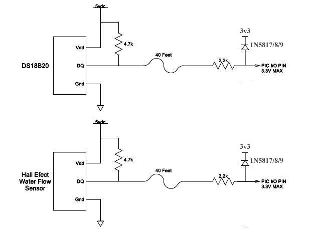

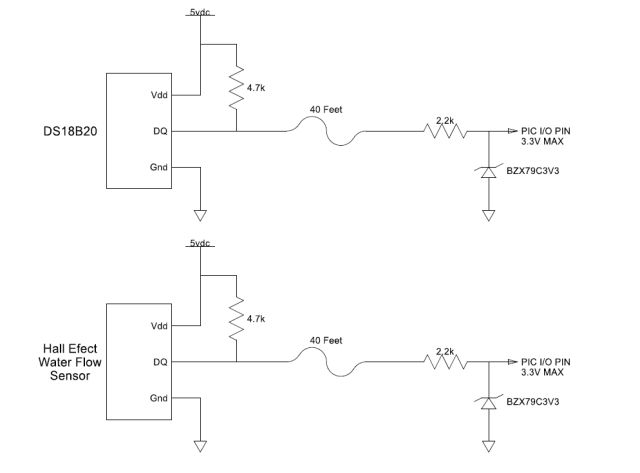

The only way is to try it... As long as the pin gets pulled low enough, it should work... Hey, it's only 40 feet... These IC were suppose to do this medium length bus stuff..
Posted: 07:19pm 18 Nov 2016
Hi Paul,
Zeners have a horrible drop off curve and as such are not suitable for Analog (not saying you want Analog) will probably be OK for Digital signals but you might be better off using 1N5817(or1N5818/9) pulled up to 3v3 as a clipping circuit.
The max voltage at the PIC pin should be no more than 3v6 (lower with the 5817) which is within the voltage range the PIC can run at and through your 2k2 Ohm that would limit the current anyway.
Such as:

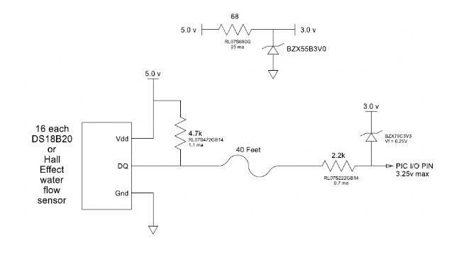

Hi Mick,
You're probably right about using a Schottky diode as a clamp. But I don't like putting more than 3.3v on the PIC pins.
Would it be better if I used a series resistor and a zener on the 5 v supply to create a 3.0 v shunt regulator then clamp each PIC pin to that? This way the Schottky diode will avalanche at about 0.25 v so the PIC pin would be at a maximum of 3.25 v. Each Schottky diode will avalanche at about 1.1 ma so the total drain on the 3.0 v shunt regulator should be a maximum of 17.6 ma. The shunt regulator will operate at a nominal 25 ma so the 3.0 v should be stable under all conditions.

Whoops. That's the wrong part number for the Schottky diode in that schematic. It should have been the 1N5817!

I would tend to agree with BigMik's suggestion; and there is certainly no issue with the low current clipped 5v input to the PIC.
The only thing I would add is to try Mick's method in your 'noise' environment and check it works as you need. Solder a quick test circuit (do not use a breadboard!) and run it through a long length of cable with the 4K7 at the sensor end, and the limiter resistor and clamp diode at the PIC end.
You may need to 'tweak' the value of the limiter resistor to somewhere between 1K and 10K - possibly depends on your 'noise'!
Let us know what you end up trying/doing as this topic comes up a fair

@Mick -- I don't think the clipping circuit will work with the DS18B20s powered by 5v. The clipping circuit is essentially one directional, from 5v to 3.3v. I don't think it will work when the PIC transmits the setup command from the 3.3v side to the 5v DS18B20 side to begin a conversion.

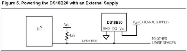

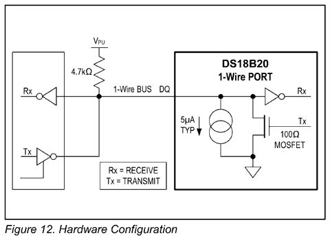

the data pin of the ds18b20 is open drain, see the below from the datasheet:
as such, there is no need for any level translation. the 4k7 pullup resistor, if connected to 5v, will provide insufficient current (less than 400uA) to in any way upset any of the micromite's 3v3 inputs.

  robert.rozee said  the 4k7 pullup resistor, if connected to 5v, will provide insufficient current (less than 400uA) to in any way upset any of the micromite's 3v3 inputs.
storm, teacup.
rob :-)
...and there you have it folks. With that being said, I would be inclined to just forget the level-correctors completely.

  Paul_L said  What is the input impedance of the sensor data pin and the PIC data pin when they are both HI? If the combined parallel impedance of both is 10k that would be in series with the 4.7k resistor. The voltage on the data line would then be 3.3 + (5-3.3)(10k/14.7k) or 4.46v and the current in the 4.7k resistor would be 1.7/4.7k or 362 ua. You are correct that this would not bother the PIC inputs.
neither pin has a "HI" state as such - they are either pulled to ground (logic '0') by an open-drain mosfet, or high impedance (input/logic '1'). the impedance at the '1' state is dictated entirely by the 4k7 pullup resistor, a component that is essential for the bus to work. the value of this pullup resistor is dictated by the drive capability the ds18b20's data pin, and as such you don't have much leeway to change the value (at best, you may be able to halve it).
being a bi-directional bus with direction outside of your control, the only real option is to either place a small micro with each ds18b20 in order to provide a more robust interface (rs485 or ttl rs232), or, to place your micromite closer to the sensors (or use multiple micromites).

  robert.rozee said  neither pin has a "HI" state as such - they are either pulled to ground (logic '0') by an open-drain mosfet, or high impedance (input/logic '1').
Exactly what I thought Rob. When either the PIC pin or the sensor pin is in a high state its impedance to ground is very high, probably >> 1M, but neither pin can source any voltage. This means that the full 5 v from the 4.7k pullup resistor appears on both pins. A level translation circuit pretty much has to be provided near the PIC chip if a non 5v tolerant i/o pin is being used.
At TTL levels any voltage below about 1.5 v will be recognized as LO while any voltage above about 3.5 v will be recognized as HI. The indeterminate range is 1.5v to 3.5v. If the input uses a Schmitt trigger then hysteresis will reduce the indeterminate range to 2.2v to 2.8v.
Any noise voltage coupled into the long line will see a very high impedance >> 1M to ground when both pins are HI. Since the equivalent source impedance of this coupled noise voltage is very high ( >> 10M ) we should be able to attenuate the noise voltage by coupling it to ground through a resistor, 10k in this example. This produces a voltage divider instead of a pullup resistor and limits the HI voltage to 3.4v, but it would attenuate a 500 mv noise voltage with a source impedance of 10 M to 5 mv. If the PIC pin began drawing a current of 0.1 ma in the HI state that would increase the current in the 4.7k resistor to 0.34 ma and reduce the voltage applied to the PIC pin to 2.93 v in the HI state.
Would you feel safe in applying this 3.4v HI voltage to a non 5v tolerant PIC pin through this voltage divider?
Can any or all of the PIC pins be set to not source any voltage (open drain/collector) in MMBasic code?
