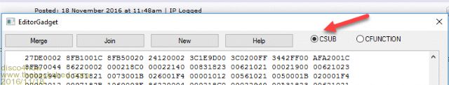

Your C function does not return anything so I am guessing you are probably calling it like a sub.
e.g
set_pinout(x)
This will give an 'unknown command error.
y=set_pinout(x) is how you call a function.
When you convert to MMBasic select the CSUB option instead of CFUNCTION
and you will get something like below.
CSUB set_pinout
00000000
3C03BF81 8C65F220 3C020661 7CA5D800 3444A053 50A40009 2402002C 8C64F220
2443A053 7C84D800 00832026 2402001C 2403002C 0064100A 3C03BF81 8C66F220
8C64F220 3C030580 3463A053 7CC6D800 00C33026 24050040 7C84D800 24631000
10830006 00A6100A 00022FC3 00402021 00801021 03E00008 00A01821 24040064
00002821 00801021 03E00008 00A01821
End CSUB
This can be called as a Sub. e.g.
set_pinout(x)
We can help a lot easier if you post the MMBasic code.
Gerry

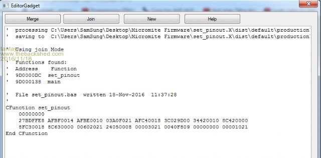

And convert using CFGEN.EXE
program MMedit:
OPTION EXPLICIT
OPTION DEFAULT NONE
cpu 40
pause 50
CONST SDA = 24 'SDA of FT6206
dim i% = set_pinout(24)
do while(1)
loop
end
CFunction set_pinout
00000000
27BDFFE8 AFBF0014 AFBE0010 03A0F021 AFC40018 3C029D00 34420010 8C420000
8FC30018 8C630000 00602021 24050008 00003021 0040F809 00000000 00001021
End CFunction
When load program in to microcontroller then error
Thanks all

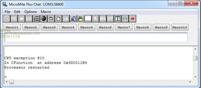

I'm try on write I2C software talk with FT6206 touch controller. I refer one article in forum but when convert to MMbasic then Error and i don't talk with FT6206
this is project
2016-11-18_081543_CapTouch.X.zip
The optimization level is set to 1 and add "-fPIC -mno-abicalls" under "XC32(Global Options)"
Help me
Thanks all

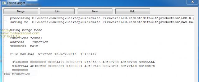

Posted: 12:00am 18 Nov 2016
Your issue is that you can't call one routine from another. Do read all the tutorials to see how I do it.
All calls must go through "main" which than acts as a switch to call the other routines. CFGEN is then used in "merge" mode to create a single CFunction with a single entry point.
In 5.3 it will be possible to write loadable drivers for touch as well as for displays. I've already done this for a client using the FT6206 and a modified version of 5.2. Geoff is including the hooks for this in 5.3
