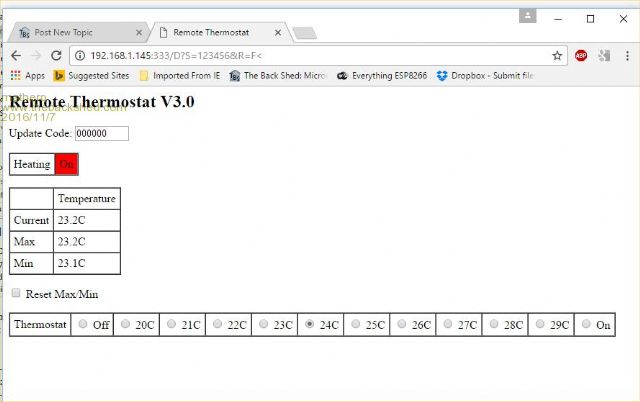

The attached code is for a simple remote controlled thermostat but contains all the elements needed to set up the ESP8266 from "as-flashed" state and connect it to a router.

In the attached code just change the constants
CONST SSID$=quote+"mySSID"+quote
CONST SSIDPassword$=quote+"mySSIDpassword"+quote
to attach to your router.

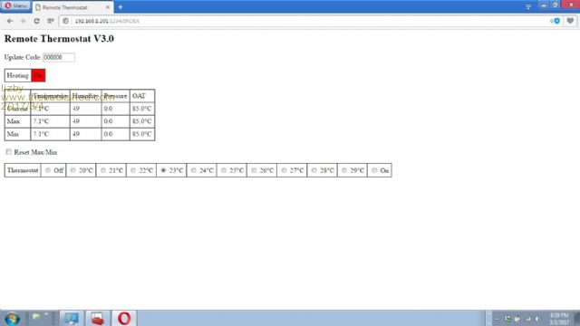

Posted: 07:33am 03 Mar 2017
In trying this very nice piece of software I was stumped for a while with this error while running on an Explore64 with MMBasic 5.3b:
Page$=UCase$(parsehtmldata$(nparams))
Error: Invalid syntax
I finally figured out that "Page" is now a command. Changing all instances to "pageX" fixed that.
Now I have an error sending the html back to the browser.
[code]
Opening COM3
Reopening COM3
Getting IP:
IP: AT+CIFSR
+CIFSR:STAIP,"192.168.1.201"
Connected
nparams: 0: |INDEX|
ERROR : AT+CIPSEND=0,173
ERROR : AT+CIPSEND=0,185
ERROR : AT+CIPSEND=0,238
[/code]
The first 6 lines plus the line after "Connected" I added for diagnostic purposes. Other than removing the calls to the BME280 (and setting appropriate values for data from it), I didn't make any changes to the parsing code.
I'm connecting with a ESP-001. The program says it has connected. In response to my browser request of http://192.168.1.201:1234/INDEX (which the line after "Connected" indicates id being received), I get "The 192.168.1.201 page isn’t working".
Anything to try to get past this sending error?
Edited by lizby 2017-03-04
Posted: 03:42pm 03 Mar 2017
This is perplexing. It works for me with IE, Opera, Safari, but not with FireFox or Chrome.
Edited by lizby 2017-03-05
Posted: 06:33am 04 Mar 2017
Ok, it was a rendering issue. Firefox considered the page to be text, and showed the raw html.
Chrome sent back to the ESP8266 that what had been sent to it was invalid, so I got the messages, "ERROR : AT+CIPSEND=0,239".
IE, Opera, and Safari figured it out and rendered the raw html appropriately.
Adding this line at the beginning of sub drawpage made it so that it works in all 5 browsers:
sendText "HTTP/1.1 200 OK"+crlf+"Content-type: text/html"+crlf+"Connection: close"+crlf+crlf
Posted: 06:48am 04 Mar 2017
Looks like they have changed something on Chrome. I did all my development using it and had no issues.
Anyway, very well diagnosed - sorry I couldn't help
Posted: 08:25am 04 Mar 2017
It may well have been a setting or an extension, but I have no idea where to look.
Sorted now, for me.
Posted: 04:50pm 04 Mar 2017
