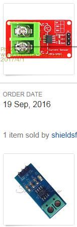

I use the ACS712 for low currents 5, 20 and 30 A bidirectional
and the ACS758 for 50A and above
They have a +/-100A and 100A unidirectional, one of which would be ideal for your 80A
The advantage over op-amps is they are isolated and can be put in either the positive or negative rail.
They require a 5V supply.

I agree with Jim, the ACS758 would be ideal for you. You can buy them as individual chips or as a module - the latter available on ebay for around $15. I have used a number of these with a Maximite and they work a treat. Just a resistor divider to bring the 0 to 5V output of the ACS758 down to a voltage that the Maximite can handle and possibly a capacitor to stabilise any noise.
Doug.

The ASC712 units output 2.5V with zero amps flowing.
If you install them the right way around, the output will go lower with increased current.
I am using 30A ones on my solar monitor. With 11 amps flowing the 'wrong' way, the output reaches 3.3V
One sensor I have can go that way when an AC charger is running but it's output is less than 11A so I have no problems.
Under normal current flow 30A would have the output at about 0.5V so there is no need for any voltage conversion.
I had 'fun' getting reliable zero current readings. I will post a description of my efforts 'soon'

Like Jim, I had trouble getting the zero current reading correct and reliable. My approach ended up using ACS758 modules with the bi-directional version.
As I only needed to monitor current to 50A, I used the +/- amp version. Each module has an LM317 variable voltage regulator on it and I modified the output adjust resistor divider chain by adding a 250 ohm 25 turn trimpot into the chain such that I could adjust the supply to the ACS758 from 4.9volts to 5.1 volts. This in turn allowed me to "tune"the zero current point to exactly 2.5 volts. I have 5 ACS modules set up this way to read a range of charging and load currents in the van.
In the umite, I read the output of the ACS758 directly with 2.5 volts equal to 0 amps and 0 volts equal to 50 amps. So, input pin minus 2.5 times 20 gives a direct current reading.
There is a bit of loss of linearity as the ACS758 output gets close to 0 volts (50 amps) but as I only need to work from around 0 amps to a max of 30 or so, it is not a problem for me. The supply to the mite needs to be exactly 3.3 volts with as little system noise as possible (as you would expect).
For voltage measurement, I use the standard resistor divide chain but add in the 25 turn trimpot to "tune" the values as needed.
Checking with a good quality meter, both voltage and current readings are good to about 1%, more than sufficient for my requirements.
