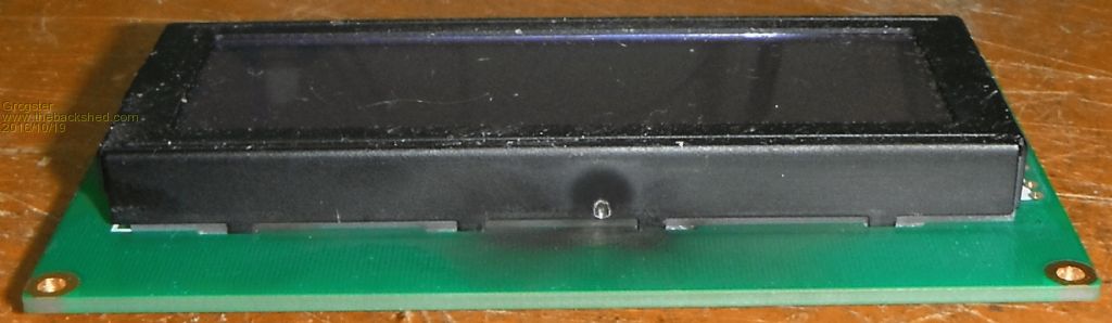

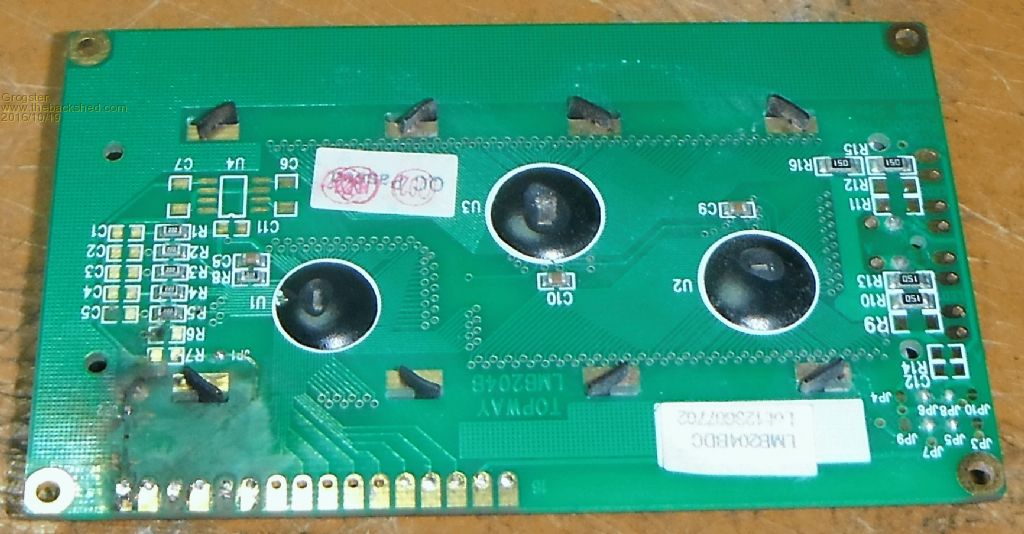

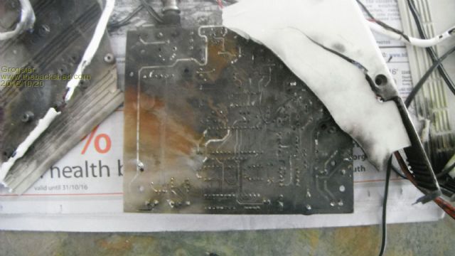

Here is the LCD module I extracted from the system during some initial investigation as to how serious a fault we had:
Blown the top off all three controller chips on the LCD, burnt out a ton of tracks on the bottom-left, and the 2nd image shows a discharge path that left a very noticeable pit in the metal LCD shield.(this looks like it was the exit path to the chassis)
Some serious juice flowing around there when it happened.
Impressive though - in an electronically-fatal way.

for most strikes the voltage differential created for hundreds of metres around the point it touched the ground is enough to kill most things.

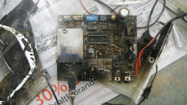

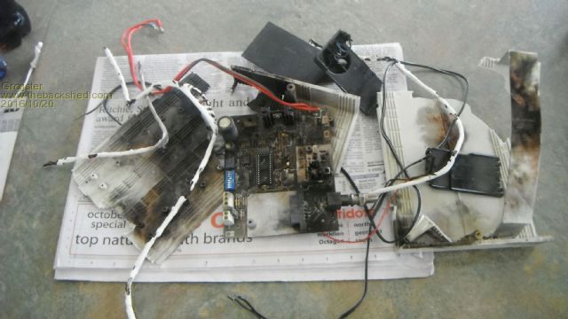

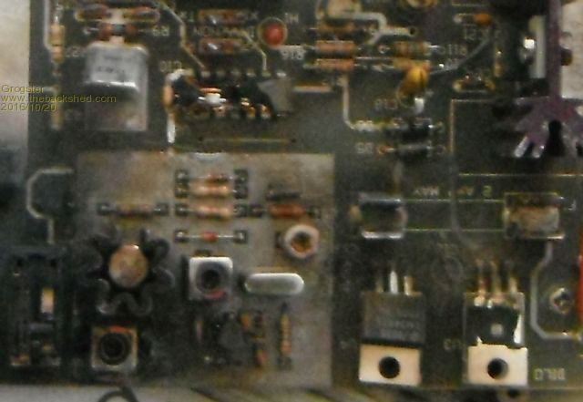

That USED to be a nursecall system repeater. This was in the area of the main strike.
Whaddya think?
Bit of solvent, a clean, and a new battery?
This is a real pain in the arse, as that repeater serviced call point in rooms, and without it, they are all off line. You can't buy that old repeater equipment anymore, and we were going to upgrade that sector, but I was not planning to do it before Christmas. Looks like that - along with just about everything else, is now going to be a rush-job, and I don't like them for the stress level, but have already kinda decided to just run with it - you can only do what you can do, so a bit of progress each day, and eventually I should get everything back on-line again.
TV system has a whole heap of holes in the signal. SO FAR have only found splitters and amps that have been fried, and keeping my fingers crossed that none of the underground cable runs have been blown, cos that is digger time to fix, and just takes so much time......
.....all the while, people asking you if they will have TV back on for the news.
Posted: 08:21pm 19 Oct 2016
Out of interest Grogs, did it 'blow' the 28pin DIP out of the socket, or was it already unpopulated?
Like you say, bit of a clean, few track repairs, and all should be fine
Please keep sending the photos (if you get the time to!). Quite an eye opener to see this kind of stuff.
Posted: 08:30pm 19 Oct 2016
The control chip is supposed to be in that socket - one of those old EEPROM's with the window, and you would erase them in a UV cabinet - pretty old technology.
A bit more of a close-up:
Note the 14-pin DIL chip in the upper left of this shot - plastic case blown right off it. Along with the regulator down the bottom-right. Relay at bottom-left used to have a top bit. Fuse gone.
Even the plug-pack which ran this has been blown to bits. I can't even FIND the core, all that is left, is the case of the plug-pack, all blown to bits. It shattered the 230v outlet it was plugged into - just three burnt ends hanging off the T&E feed cable. This has been removed and terminated by the sparkie, so I did not get a shot of that before, sorry.
There is supposed to be receiver card in the blue edge-connector - what's left of it - and that was blasted out of the box and is embedded in the roof paper. I will try to get a shot of that tomorrow.

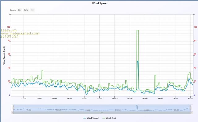

There was one close strike (1km away - not as close as last time and definitely not as close as Grogster's) at about 3am.
My weather station recorded a spike in wind speed and at the time the windows on the house rattled severely.
I don't know if the recorded gust was real or the result of induced currents in the wind speed sensor.
So far, everything seems to have survived.
