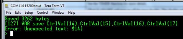

I have a GUI spun up that uses number boxes and I tried to store there values in the Flash memory area...
I keep getting this error...
Not sure why... Do I need to read the control values to some other variable then store the other variable..?

CTRLVAL is a function/command so I expect that you do have to use a true variable for saving.
You can use an array.
JimEdited by TassyJim 2016-10-14

Yep... thanks Jim...
