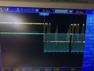

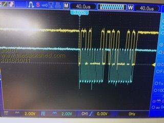

Posted: 10:24pm 10 Oct 2016
Battery hooked up, diode removed.
RTC gettime with DS3231 looking at data / clock. Not working.
RTC gettime with DS1307, same pins on explore100. Working.
I did try swapping the data and clock around. Gotta be something I'm doing wrong.
Posted: 11:10pm 10 Oct 2016
If you plug the module into the E100 as in the picture and it doesn't work then, given you can run a DS1307 in the same connections (prove it at both ends), the DS3231 must be faulty. They just plug in and work once the OPTION command is set - there is very little scope for getting this wrong in any way
