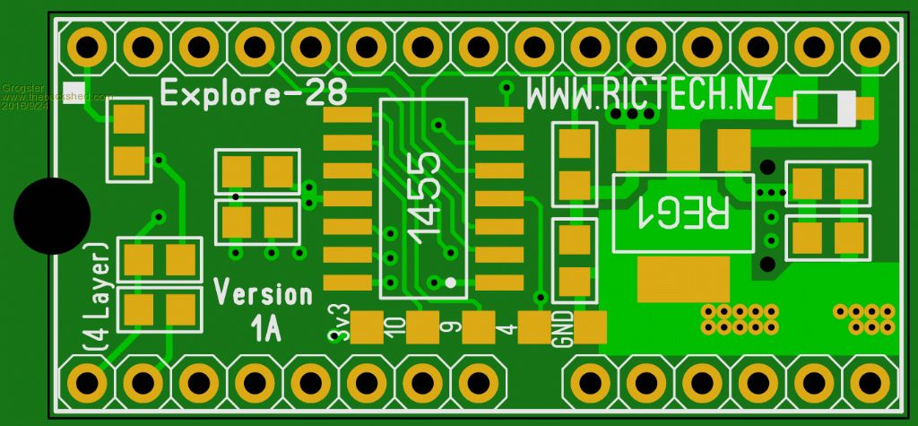

Hello all.
Here is the latest module:
This board was co-developed with robert.rozee, and it was HIS idea.
He asked me if I wanted to help with the PCB design. As I love a challenge and knew this one would be a tight-fit, I was all for it - it's all good practise for me.
Geoff has approved my use of the "Explore-28" name.

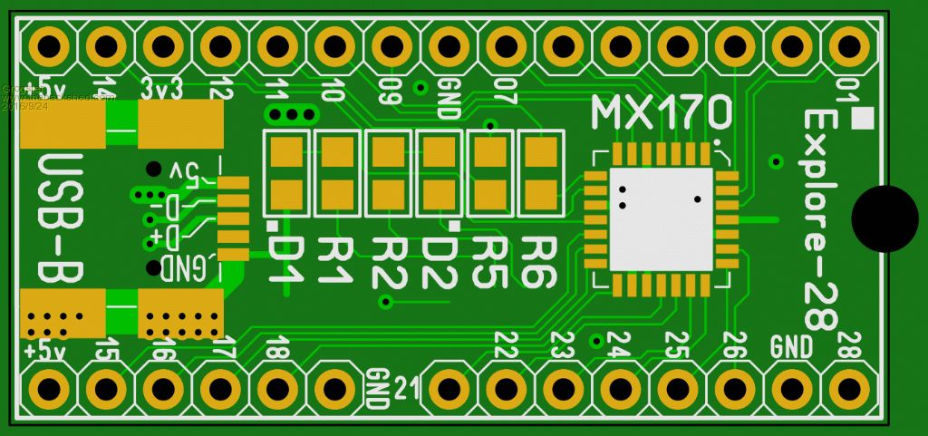

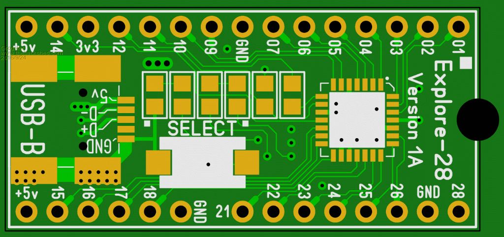

What's great about this design, is that you can do away with messy USB-serial adaptors and linking wires, as it is all on-board - just plug in a USB cable.
This board uses the 1455 chip for a USB interface and ICSP all via the same USB cable and the ASCII ICSP tool - no need for 100MB+ of Microchip IDE package to get the IPE, and no need for a PICkit-3 either - all programming is done by the 1455 chip and standard USB cable + the free ICSP tool.

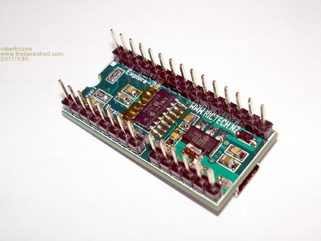

As you can see from the last image, the board is tiny for what it contains, and is not a great deal bigger then a standard DIL 28-pin chip is.

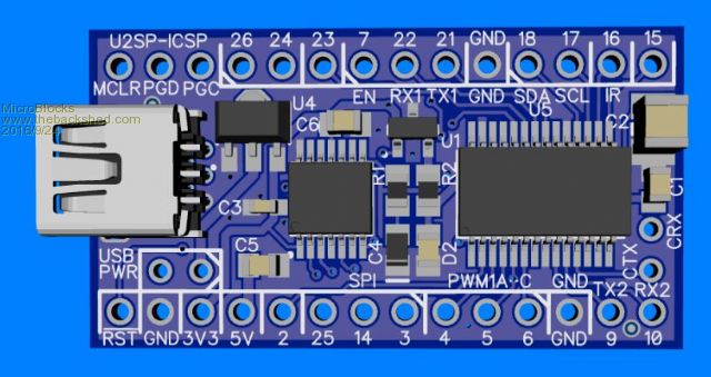

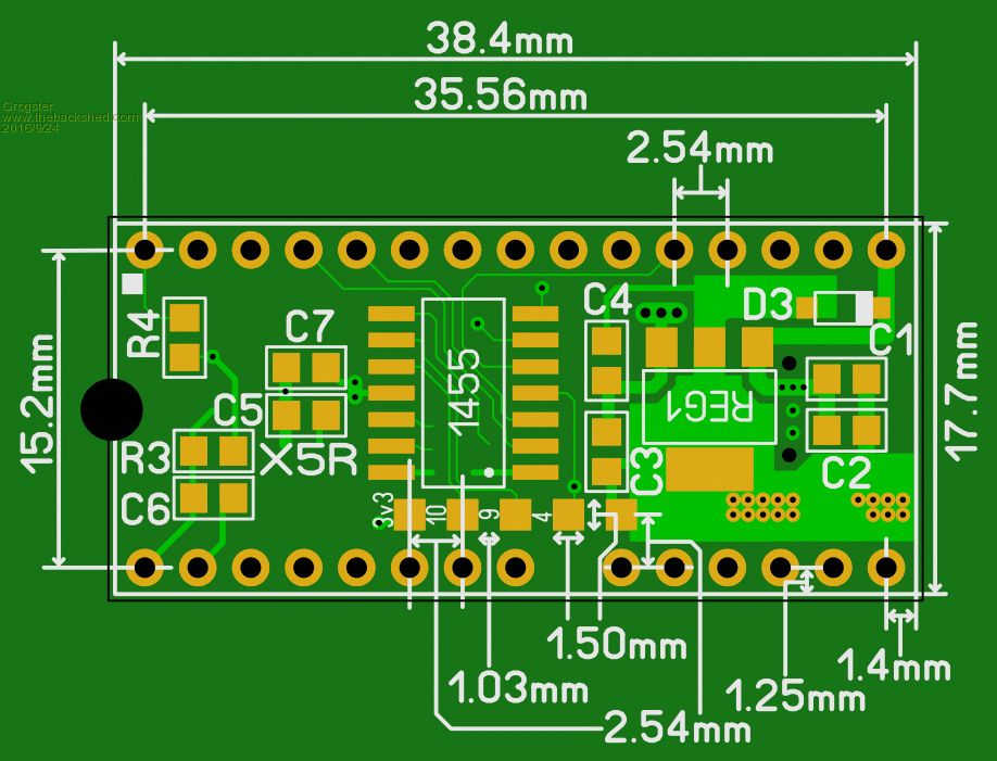

There is a separate dimensions/legend image, as including even the component ID's on the silkscreen made the board look very crowded silkscreen-wise, so we decided to just omit it completely, and have another image with a nice big legend on it. On that image, parts that are on the board that were in the way of the legend were removed from the image - such as the SELECT button.
This board uses the PIC32MX170 chip that is at the heart of the Micromite-2, but in the tiny 6mm square QFN package. This chip is PROBABLY not possible to hand-solder without the help of a microscope - 6mm QFN's are not very big!
The 1455 chip on the bottom is standard SOIC package. Regulator is SOT-223, LED's and the passives are all 0805, and diode on bottom of board is SOD-123.

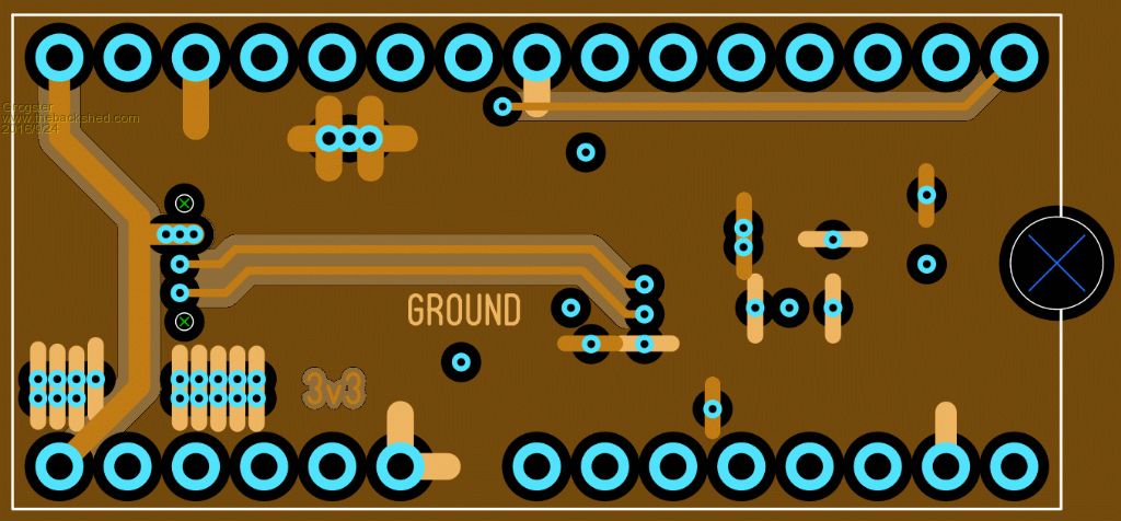

The PCB is four-layer, with the inner layers being used as power and ground in a pretty standard arrangement for four-layer design. Despite the board being four-layer, they work out very cheap on a per-board basis because of their small size - around 50c a board(plus freight), which for four-layer is very cheap.
I will be selling boards, kits and assembled modules from my website in due course - the boards have been ordered so should be here in a couple of weeks, and the chips and other parts are also on-order. I have not worked out prices yet for kits and assembled modules, but I will post that here once I have.Edited by Grogster 2016-09-25

Here is my version (not for sale as i focus on other things now, so please do not see it as competition but an alternative possibility to layout the pcb with SSOP packages!)
Edited by MicroBlocks 2016-09-25

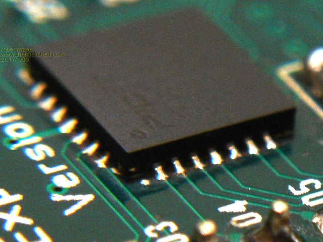

Out of interest, what was such a pain in the posterior when soldering QFN's?
Just that they are tiny?
Posted: 05:23am 24 Sep 2016
The biggest pain was the amount of solder paste.
A little bit too much and you'll have shorts, a little bit not enough and you have unconnected pins. A bit too much on the center pad and you often have one side hovering over the pads without all of them connected. A reflow repeat is a way to fix that, or removing the chip and do it again.
Getting them equally heated (center pad and the pins) is another but that can be solved with a good hot plate or oven.
After a lot of practice it is better to use a little bit less solder paste on the center pad.
Some pcb's i had before that had a solder finish on them could hold the qfn's without adding any solder paste, just some flux. :)
Inspecting can only be done really good by using X-ray. Otherwise it is just inspecting with a side view of the pins. A jig to test each connection and a way of determining that there are no shorts between pins is a must.
For automated placement/reflow like the professional assembly houses do it is not really a problem. When you need to do them by hand it is way to much time.
Hotplate or reflow oven with a good stencil is somewhere in the middle.
I have about 450 pcb's left that were made for QFN's. The about 100 i made just took to much time. I got pretty good at it but even then it was too long.
In contrast a SSOP is much easier. The amount of solder is less critical, inspection is much easier, placement is easier, fixing a bridge is easier etc..

Posted: 09:31am 24 Sep 2016
the connection to the centre pad is optional (it is electrically isolated), leaving this out as grogster has done removes many issues.
the board is the same footprint as an arduino nano, hence the need for going QFN. the above blue layout looks to be 0.1" wider, yes?
rob :-)
Posted: 10:19am 24 Sep 2016
The distance between the top and bottom row of pins are 600 mil.
Same as a DIP28. The dimension are such that it can be used with a standard DIP28 socket or ZIF socket.
Leaving the center pad unconnected can be done but then you loose the thermal connection which leaves only the pins (that are under the chip) to dissipate the heat.
A QFN package is specifically designed to dissipate the heat through the center pad.
A soldermask and tented vias (and silkscreen) adds an insulating layer that further minimizes the center pad to dissipate heat. It basically renders the center pad useless for its intended purpose.
Extra caution will be needed to not stress the chip as specified maximum values in the datasheet will have to be lowered considerably.
Another thing to consider is that QFN packages can easily shear off when only the pins are soldered.
SSOP or SOIC has a lot bigger pins that can easily dissipate the heat, so no need for a center pad in those packages.
There is a small table in the datasheet that specifies the junction to ambient thermal resistance for the different packages.
[code]
TABLE 29-3: THERMAL PACKAGING CHARACTERISTICS
Characteristics Symbol Typical Max. Unit Notes
Package Thermal Resistance, 28-pin SSOP čJA 71 — °C/W 1
Package Thermal Resistance, 28-pin SOIC čJA 50 — °C/W 1
Package Thermal Resistance, 28-pin SPDIP čJA 42 — °C/W 1
Package Thermal Resistance, 28-pin QFN čJA 35 — °C/W 1
Package Thermal Resistance, 36-pin VTLA čJA 31 — °C/W 1
Package Thermal Resistance, 44-pin QFN čJA 32 — °C/W 1
Package Thermal Resistance, 44-pin TQFP čJA 45 — °C/W 1
Package Thermal Resistance, 44-pin VTLA čJA 30 — °C/W 1
Note 1: Junction to ambient thermal resistance, Theta-JA (čJA) numbers are achieved by package simulations
[/code]
The values for a QFN are considerably lower. And those numbers are for a connected center pad.
The biggest impact on that number in the case of a QFN is how the PCB is designed with regards to the center pad, how many layers, vias etc.
This is considered the biggest influence. JEDEC specifies exactly how these values have to be measured and the way it is mounted on the pcb is considered as a 100% effect on the results.

Posted: 06:15pm 24 Sep 2016
GDay Rob,
  robert.rozee said   the above blue layout looks to be 0.1" wider, yes?
Doing a Photoshop resize to do a comparison it appears that Grogster's board and Jean's board are the same height with a 0.6" pin spacing, but Jeans board has a bit more PCB substrate top and bottom making the PCB itself 0.05" higher.
With the Width measurement Grogster's is 0.1" wider than Jean's board..
Not that this is a `mine is bigger than yours' comparison.. Just interesting that two almost identical boards are out there..

Posted: 07:30pm 24 Sep 2016
Grog's board is 30 pin. I think you would need to use 32 pin sockets but that's no big deal.
I like Grog's pinout - the same as the 28 pin DIL chip with the 5V added at the end.
My own version made on my CNC will end up about 4 times the size.

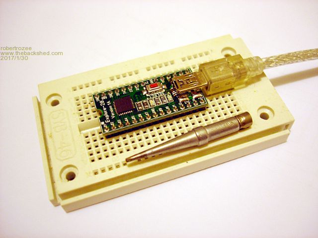

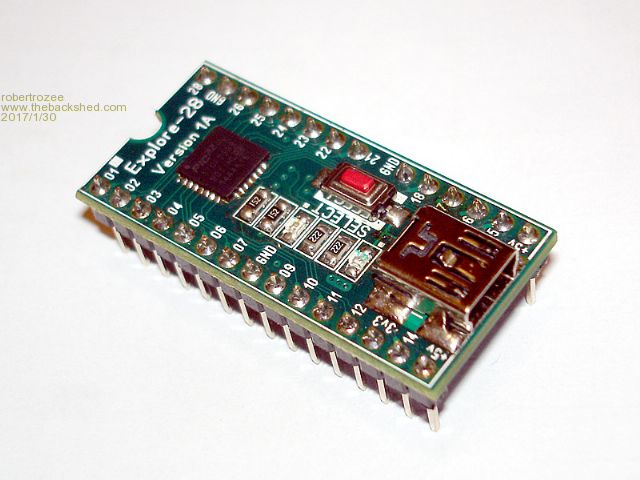

Posted: 07:20pm 29 Jan 2017
actual hardware, assembled and running:
rob :-)
