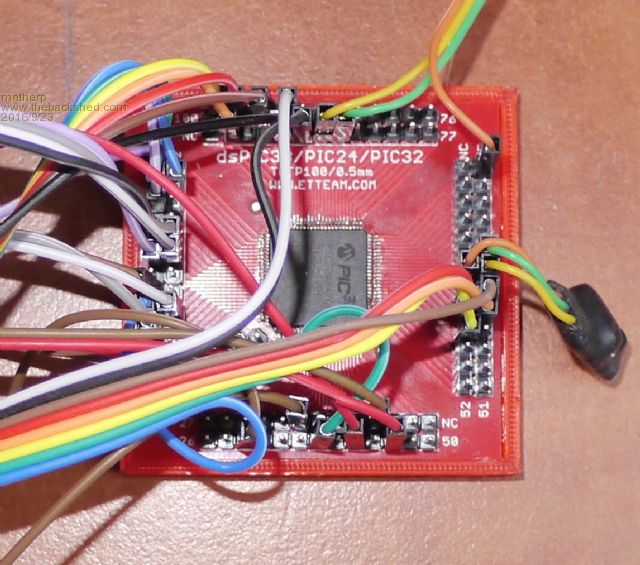

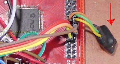

Phil23
Joined: 27/03/2016
Posts: 1667
Posted: 09:46pm 23 Sep 2016
Pure curiosity...
What's that?
Phil.
Posts: 10076
Posted: 09:53pm 23 Sep 2016
Yeah, I was eyeing that thing up myself!
I expect it is an encapsulated USB-serial converter thing that matherp may have baked at home.....
EDIT: On second thought, it is probably the 20MHz oscillator for the PIC32. I think I see what looks like a crystal outline under that heatshrink. Edited by Grogster 2016-09-25
Posted: 10:08pm 23 Sep 2016
Especially when it's connected to the oscillator pins of the MCU (RC12 and RC15).
Phil23
Joined: 27/03/2016
Posts: 1667
Posted: 10:15pm 23 Sep 2016
  Grogster said   Yeah, I was eyeing that thing up myself!
You're right!
Pins 63, 64 & 65.
Probably the oscillator & a couple of Caps going of the E100 schematic.
Phil.

Posts: 12084
Posted: 10:33pm 23 Sep 2016
  Quote  Probably the oscillator & a couple of Caps going of the E100 schematic.
Correct. The other thing needed to get the ETTEAM board going is a wire from pin-37 (AVCC) to VCC as this isn't included in the layout.

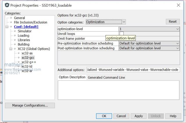

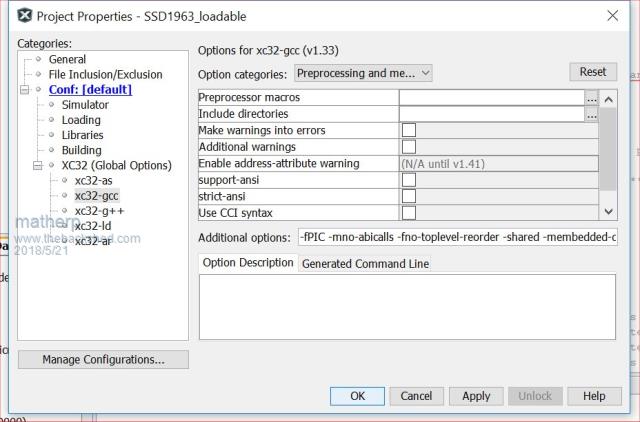

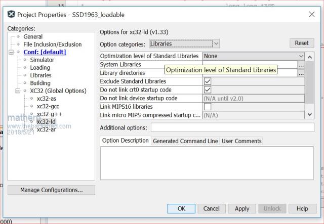

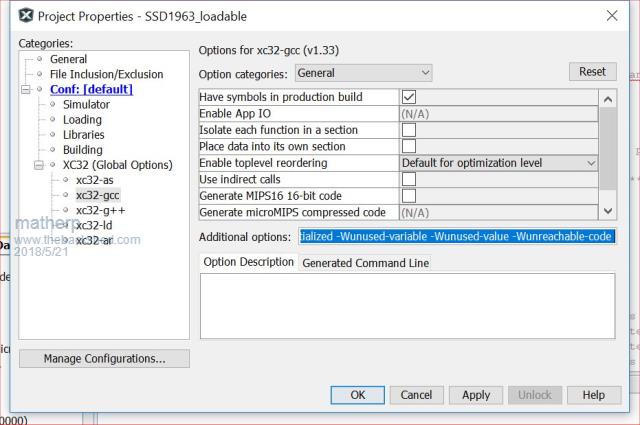

I am trying to compile 2016-09-24_082157_SSD1963_loadable.zip source C file using MPlabx following the CFunctions tutorials given by matherp.
The pre-compiled version works without fault as expected, but MY compiled version doesn't give the console message correctly when processor rebooted. It puts to the console many CHR$(156) 'a "Y" with 2 dots above it' in a row , any Ideas???
I wonder if I missed a setting or something or as it is fairly old code has there been some changes I don't know about?
Trevor
Posts: 12084
Posted: 01:31pm 21 May 2018
  Quote  I wonder if I missed a setting or something
Things to check
You must use XC32 V1.33
Additional compile options must be:
-fPIC -mno-abicalls -fno-toplevel-reorder -shared -membedded-data -mno-long-calls -fno-jump-tables -mno-jals -mgpopt -Wuninitialized -Wunused-variable -Wunused-value -Wunreachable-code
Optimisation set to 1
All other setting as below - check loader options carefully
