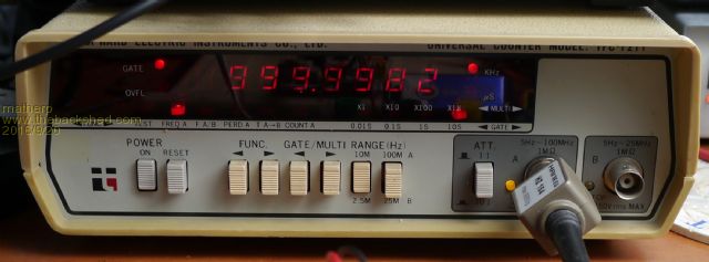

Lew247's post in this thread prompted me to write a tiny bit of code that has been on my to-do list for ages: to use the internal temperature of the MX170 to get the internal clock as accurate as possible over 24-hours.
The picture is of my counter/timer set up with a 10-second gate time measuring a 1MHz output from the Micromite
The way the code works is as follows:
First you need to find the OPTION CLOCKTRIM value that would give a perfect result at any given temperature. In my case a trim value of -2.67 at 23DegC
The code then uses as an input the sensitivity of the clock to temperature and to an incremental change in clocktrim
const tempadjust=0.12 'No. of KHz by which a 1MHz output clock decreases per degree rise of temperature
const trimadjust=0.45 'No. of KHz by which a 1MHz output clock increases per unit of OPTION CLOCKTRIM
The temperature compensation is set as a constant at 0.12KHz/deg which is the value I have measured. The impact of 1 unit of OPTION CLOCKTRIM is set at 0.45Khz/unit. Both of these are related to a 1MHz reference output.
I set up a 1 second interrupt with a 10 second calculation within it. The code then works out which integer value of clocktrim to use for the first part of the 10 seconds, when to make a change and then the value of clocktrim for the second part of the 10-second period.
i.e. within every 10-second period CLOCKTRIM will be updated twice to both add an effective decimal point to the clocktrim value, and link in the temperature compensation.
This should give an accuracy of within 5 seconds a day.
Full code below

So, this program runs for 24hrs and keeps adjusting the trim for a given room temp (or other environments), then you quit the program with the best value stored..
Hence, a single pass setting, or do you recommend this run as a background task while the main user program is running..?
Posted: 09:28pm 20 Sep 2016
  Quote  or do you recommend this run as a background task while the main user program is running..?
That was the intention. I'm currently running the code in the background in Geoff's "SuperClock" as a test will report results after a couple of days

I don't quite get it
do you have to have a frequency counter connected while this is running?
or do you have to measure the clocktrim at given temperatures then run the program?
my clocktrim is 4 at 23°C would I have to measure this a 22 and 24 deg to get it to work?
I don't "quite" get what this needs

It is a good idea, though I think the non-crystal oscillator is basically a
R-C circuit so the frequency is affected by power supply voltage as well (?)
