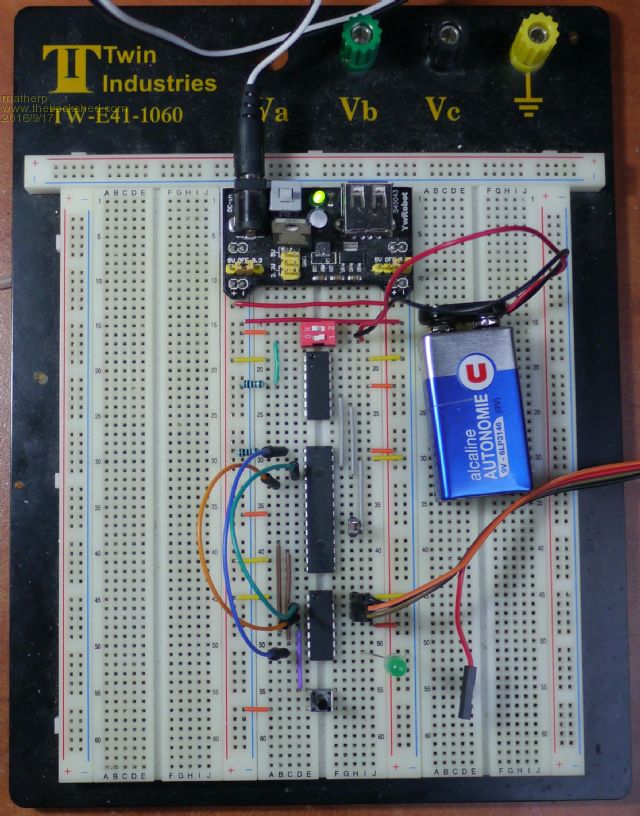

The picture shows my development environment. The bottom PIC16F1455 chip is providing the serial connection to the PC. The top one is wired ready to be programmed. Before anyone asks, I use LEDs with built in resistors for prototyping which is why the green LED is connected direct to the Micromite - makes life much easier
The wiring and programming process is simplicity itself.
PIC16F1454/5 connections:
Connect GND to pin 14
Connect 3.3V to pins 1 and 11
Connect PGC (pin 9) and PGD (pin 10) to two Micromite output pins. I've used pins 25 and 26 respectively.
Connect a 10K resistor between GND and pin 4
Make sure there are no other connections to the PIC16F1455
Connect the negative terminal of a 9V PP3 Battery to GND (MN1604, PP3-HP, 006P, 6LR61, 6LF22, 6LF62)
Have a wire on the positive terminal that you can connect to pin 4 of the PIC16F1455 when requested by the program, a simple SPST latching switch is ideal for this as in the picture.

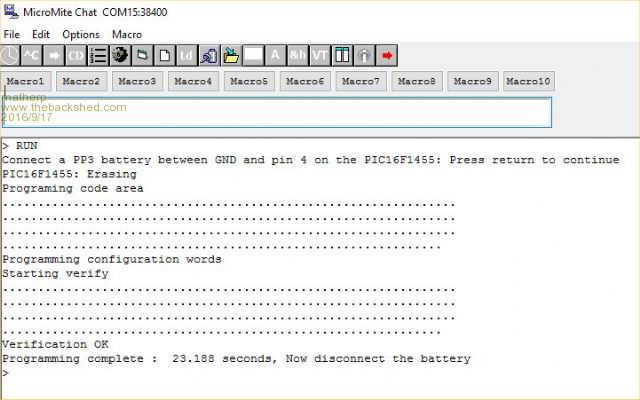

Type run
Follow the instructions
The programming session produces the following output
and the PIC16F1455 is then programmed ready for use. Any subsequent updates to the PIC16F1455 code can be done using the bootstrap loader so no need to run this program again.

Just curious about your development environment Peter,
Is there a specific reason for using the 2 red wires to bridge the power rails instead of setting the left jumper to 3.3V.
Is that a better practice for some reason.
Phil.
Posted: 11:43am 17 Sep 2016
  Quote  Is there a specific reason for using the 2 red wires to bridge the power rails instead of setting the left jumper to 3.3V.
No, it is just a legacy of having the power supply in the rightmost position with the right-hand power rails at 5V

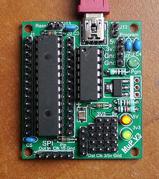

these basic programs have been written for situations where the MX170 and 1455 are on a single board together, such as Mick’s MuPV3:
