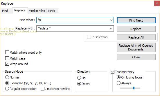

This code example allows you to display small full colour images on ILI9341 TFT displays on both the Micromite and Micromite+ and on SSD1963 TFT displays on the Micromite+ by holding the image data as DATA statements.
First save the original image file as an ASCII .PPM file using any decent photo program. You will get something like this which can be opened by any text editor.

Then we need to convert this into valid data statements. In Notepad++ a single replace will do most of the work
giving:

Now remove the header lines except for the one giving the size of the image, in this case 16 by 16 and the final spurious incomplete data line.
The lines can then be cut and paste into your program as below. Note that in the program there are four copies of the two routines DefineRegion and DisplayBuffer.
Select the versions that you need and comment out the others. MMEDIT is great for doing this using the tools in the "advanced" menu option but beware it loses the last character of the selection sometimes.
The program as supplied will run on a MX170 backpack and display the "Blinky" PacMan character at location 100,100
The biggest image that is really usable on the MX170 is about 2304 pixels (48x48) which takes 1.7 seconds to display. Example attached

Posted: 11:49am 16 Sep 2016
I will add the option to MMEdit. It's not very different to making code into comments so it should be simple to do.
