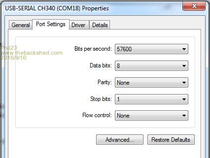

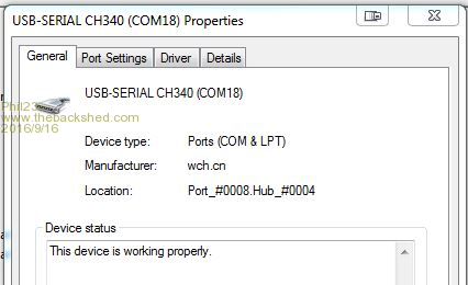

Should also add,
I can see activity on the TX & RX Leds on the Nano when I try & type something in Teraterm.
Just not seeing it looped back.
Edit:-

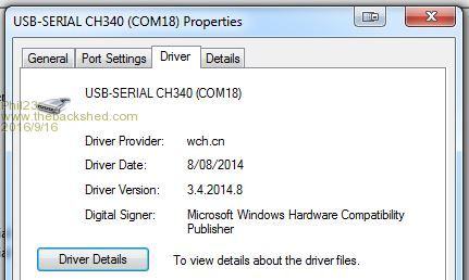

Seemed like I needed to change the Baud Rate to 57600 in Device Manager.
[Code]G:\MicroMite Stuff\PicProg32>pic32prog -d ascii:com18 -b3
Programmer for Microchip PIC32 microcontrollers, Version 2.0.220
Copyright: (C) 2011-2015 Serge Vakulenko
(ascii ICSP coded by Robert Rozee)
57600 baud ... synchronized
Signature = 1e950f Device = ATmega328P
Firmware uploaded to 'ascii ICSP' adapter OK
G:\MicroMite Stuff\PicProg32>[/code]
Looks fine now.

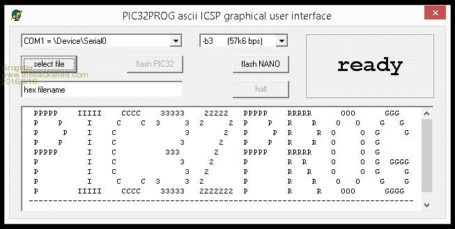

Posted: 12:07am 16 Sep 2016
Well done.
Yes, that is a bit of a catch-ya for the ASCII ICSP when you get your first one.
In order to upload the firmware to the Nano board, you usually have to set 57k6 or thereabouts baudrate, or it won't talk to it. From that point on, you should have no problems, and the ASCII ICSP does not care about the baudrate of the VCP once it is running - it will use whatever when it comes to using it to program PIC32 chips.
This information is in the manual that Rob wrote for this device, available from my website's download section and several other places.
I encourage you to use Rob's GUI for PIC32PROG, which makes programming chips a breeze:

Posted: 11:59am 16 Sep 2016
  Grogster said   Well done.
In order to upload the firmware to the Nano board, you usually have to set 57k6 or thereabouts baud rate, or it won't talk to it.[/quote]
Yes seemed it didn't even want to loopback at 9600, so I was stuck there briefly.
Didn't even check for loopback when I set it to 57600, it just worked.

[Quote]I encourage you to use Rob's GUI for PIC32PROG, which makes programming chips a breeze:[/quote]
Missed Rob's Pic32prog GUI, didn't come up in my first searches, only found MMFlash.
Might add a link to it here.
Phil.
