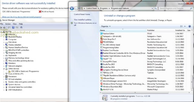

Posted: 08:44am 24 Jan 2017
Got my first two Micromites yesterday, along with bigmic's MuP v3 PCB. Soldered them up, but I can't get the usb device recognized.
On two different Win7-64 laptops I've installed the driver from bigmic's Dontronics page. It says it installed ok, but when I plug in my device, it isn't recognized.
The image below shows in the upper left what I get when I plug in the MuPv3--"Device driver software not successfully installed". The window below that shows Device Manager showing under "Other Devices" "CDC USB to Serial and Programmer" with an exclamation mark. The window on the right under Control Panel, Programs and Features, "Windows Driver Package - Microchip Technology", which I believe is the driver. I have removed and re-installed the 64-bit driver with "McphCdcDriverInstallationTool"-- still no success.
What do I need to do to install this package?
Posted: 02:28pm 24 Jan 2017
Hi Lizby,
As I have only had one order to the USA recently I assume this was yours (sent a little over a week ago). That order was for the MicroBlocks U2SP chip
The correct driver should be this one:
U2SP Driver
There is a bit of a help screen on how to install the driver located here
Help Text
The directory on the Dontronics site for MuP3 has some other useful information that may be of use as well.
MuP3
If after delving through all of that, it still isnt working for you check that the chip is being detected.
Does it beep when plugged in? Good Windows detected a USB device
Go to device Manager
Find the device in either ports or maybe other (you will see this appear when you plug it in)
Right click and select Properties
Go to details
Select the pulldown to show hardware ids
You should see the following Hardware ids
USB\VID_04D8&PID_000A&REV_0100

Posted: 03:37pm 24 Jan 2017
That did the trick, Mick. Micromites now connected and working on two laptops (one with fat, the other with skinny (retractable) usb cables).
I had to search for how to install a .cat and .inf file. Since I wouldn't remember, after putting mchpcdc.inf and mchpcdc.cat into my micromite folder, I made a batch file, u2sp.bat, with these contents:
PnPUtil -i -a mchpcdc.inf
I went to a dos prompt "as administrator", and ran the batch file to install the driver. On my older, slower laptop it took several minutes for it to install.
Where I went wrong was following the link in the second post to dontronics. I installed the only driver there, and it was the wrong one.

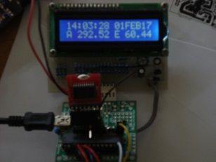

Posted: 09:58pm 31 Jan 2017
The interpreter itself is running fine and the example mostly run ok. There is a glitch though in that the more recent I/O drivers or clock timing seems to be now slightly faster and so a bit off sync. This affects the time-important I/O eg the spi, teraterm graph, and probably 16*2 lcd, and can also trigger automatic runmode so you need to hit the reset button to break the pic out of its reverie. If I use an older version, it works ok and the mup3 happily accesses a rtc via spi, generates solar position data and displays it.. so I think it is easily resolvable..only affects '170s for some reason, the other chip versions are fine.
I will fix it up.
running on mup3 , with sparkfun ds3234 RTC-
