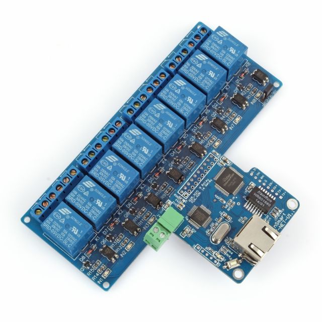

Is this something like what you are suggesting? I can't read the part numbers on this gadget. I don't know where this picture comes from or who sells this little board.

The picture you have attached shows a relay board that is designed to be controlled over the Ethernet. It is made by SainSmart and you can find more information here:
http://www.sainsmart.com/sainsmart-imatic-with-rj45-remote-control-8-channels-wifi-relay-kit-smartphone-android-ios.html
I would not recommend using an Ethernet interface as it will add unnecessary complexity to your system.
Using the I2C bus on the uM+ is a better choice. The MCP23017 I/O expander from Microchip will interface to the uM+ I2C bus and provide you with 16 additional I/O pins. With proper code on the uM+ the MCP23017 expander will operate these pins as outputs to drive the relays.
You can use two 8-relay board from SainSmart and connect each one to eight output pins of the MCP23017 I/O expander. Here is a link to the details on the 8-relay board from SainSmart:
http://www.sainsmart.com/8-channel-dc-5v-relay-module-for-arduino-pic-arm-dsp-avr-msp430-ttl-logic.html
The 8-relay board has the necessary circuitry on it to drive the coils of the relays and also provide optical isolation between its inputs and the relay drivers - an added bonus. There is no need the ULN2003A devices I mentioned in my previous message.
The input circuit of the relay board appears to be designed to operate on 5V. However the uM+ will be running at 3.3 volts as will the MCP23017. This lower voltage may not be sufficient to trigger the opto-couplers on the relay board. Short out the LEDs labelled IN1 on the relay board. This will eliminate their voltage drop from the input circuit and the opto-coupler will be able to operate with 3.3 volts input.
I hope this helps. If you need more details please let me know.

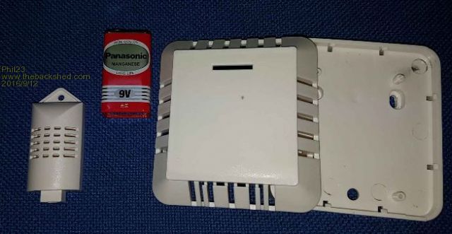

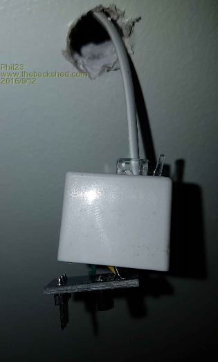

Hi Paul,
This post will give you a rough idea of how I'm connecting things.
It's really a mixed topology in my case, a mix of Star, bus & droppers.
I've also seen some 4 way splitters on ebay for a few bucks.
I've got enclosures to put the sensors in, they we a few bucks each also.
For the board end I think I'll cut off the RJ-12's & replace then with 3 pin polarised headers.
Like these.
Phil.
