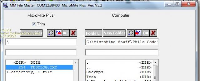

Phil23
Joined: 27/03/2016
Posts: 1667
Posted: 02:23pm 20 Aug 2016
What am I missing here?
I can download my code; done that many times before.
But how to I copy my text file off the card?
Phil.
Phil23
Joined: 27/03/2016
Posts: 1667
Posted: 02:57pm 20 Aug 2016
Thanks Jim,
Not sure if I missed something else, but while the card was in the E64 the touch did not respond.
Code still ran & it wrote data to the file, (Just formatted as CSV).
Card back out & touch came to life again. (Just had to comment out the File I/O Code).
Phil.

all the following commands are processed correctly, & the file on the card is created.
[Code]>
> Open "Test.txt" for Append As #1
> print #1, "Hello World"
> close #1
>[/code]
Slip the card in the PC:-
[Code]I:\>type test.txt
Hello World
I:\>[/code]
Phil.
No luck with any of 6 SD cards I've tried so far.
Sizes ranging from 512k up to 8 Gig.
All can be written to from the command prompt though.
But I can't even open them from within the Pump Control test code.
The only one success I've had is the one attempt on the Explore 100.
Really has me wondering if it's something hanging over from when I configured it for LED_A on pin 12.
Is there a way to reset MM.Basic at the prompt?, as I don't have a USB to TTL connected yet; still just the E64's interface, which I can't connect to until after it boots.
Phil
Edited by Phil23 2016-08-22
