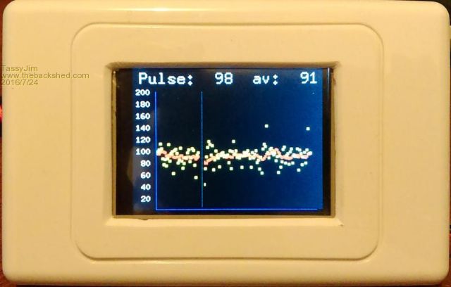

A couple of years ago I made a heart rate monitor for the Maximite.
http://www.thebackshed.com/forum/forum_posts.asp?TID=6435&KW=heart+rate
Recently, I redid the software for a micromite and LCD.
Still using the seeedstudio ear-clip sensor as I find it the easiest to use for a quick test.
I do have a 'proper' ECG but the Micromite is easiest to set up - I hate those sticky pads.
The wallplate isn't really yellow!
