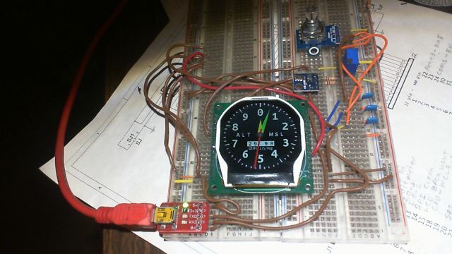

It's been awhile since I posted an update.. I took a side track and did Lou's PEMF Coil Driver PCB which should be on it's way from Iteed soon... So, back to Gauge code...
I changed the user interface from push buttons to an encoder type control with push "select" button, which works like the old school gauge. Also included 2 setup screens to change either the QNH scaled in in/mg or ALT in ten's of feet. I will be building a battery powered "test" unit and have my Bro Dave take it up for a test flight to see if it seems to work ok...
I big tip of the hat to Peter for writing the BMP180 and updated R61505V driver which supports the RD pin, that makes all this work..!
Since the gauge interface board also contains an Rs-485 transceiver, I am now thinking of transmitting the ALT information to another gauge display and create a "rate of climb" type unit... Should be doable... Project code attached if interested...

Looking really good. QNH entry in millibars ( a.k.a hectapacals ) would make it universal.
Shame that your Aliexpress supplier no longer stocks the LCD, only a slightly smaller 2.0" version of lesser resolution.

Beautiful work, I love the thin red needle
Is the background - the Black with the numbers a background picture or drawn by the Micromite?

a really neat piece of kit you've designed
note: the BMP180 is light sensitive, i found i needed to place a black light shield around the module otherwise altitude would vary by 50 metres or more if exposed to sunlight. this just by light entering that tiny little air hole in the top of the metal can.

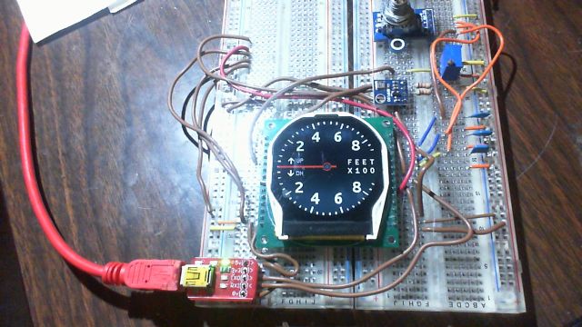

Vertical Speed Indicator add on...
I am still trying to get this worked out, but got the background screen worked up...
Instead of using 2 gauge displays, I think I can just hit the button and switch between them... I think I will need some help from Peter Mather on how to properly control the needle objects buffer to switch from showing 3 needles to just 1 on the vario display... I tried just clearing the "buff()" array but can't seem to clear the other 2 needles once they exist..

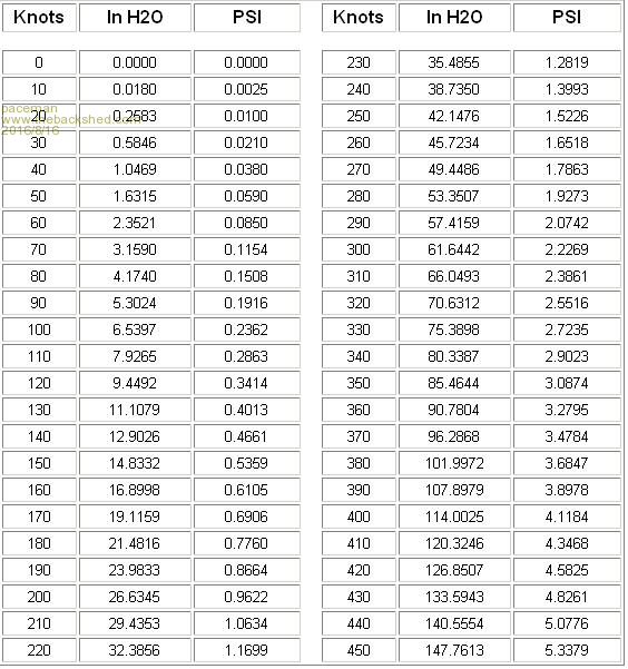

  Zonker said   I think 0 to 2, maybe 3 PSI is the range needed for an airspeed sensor (I think)...
That's too high a range - unless you've got a Spitfire . The table I have says ramspeed at 100 Knots is 0.236 psi, i.e. 6.54" H2O, so Peter's option (NXP MPXV5004DP max. pressure 3.92KPa, 15.8" H2O) is much closer and a hell of a lot cheaper (US$12.30 at DigiKey, 7.60 UK pounds at Element 14).
The Honeywell ASDX001D44R used in that earlier Sonex64 link tops out at 27.7" H20 so as he said, that's really a bit high (depending what you're flying). The more sensitive option he suggested to use is the ASDXL10D44D (DigiKey P/No. 480-1918-ND) which tops at 9.96" H20 (which would be a good range) but they're very expensive.
Peter's option should be good for mortal flyers and he says it works so I'd say that's the way to go. There might be a slightly lower range one below that now that would be better still but I haven't checked that.

I am kinda new at trying to select sensors and could not seem to find a "cheat sheet" that does all the conversion between in of H2O, PSI and k/pa...
  Quote  The table I have says ramspeed at 100 Knots is 0.236 psi, i.e. 6.54" H2O,
Can I see a copy of your conversion table you use Greg..?

  Zonker said  Can I see a copy of your conversion table you use Greg..?
It's in a .jpg file unfortunately but here 'tis.
