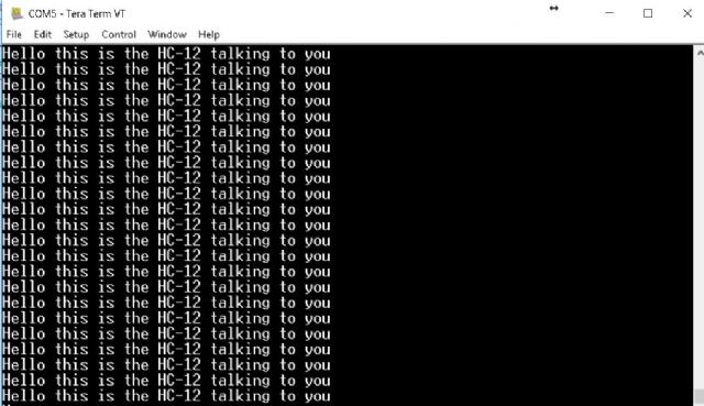

I have a program running on a 2nd micromite and it's transmitting data on it's HC-12 , and I have a 3rd HC-12 connected to a TTL converter on the PC.
On the PC I can see the data the 1st Micromite is transmitting, it receives it perfectly.

I can definitely see the characters scrolling up the screen on the pc console HC-12 so the Micromite+ one should be the same (the "testing" is in a loop so it continually scrolls)

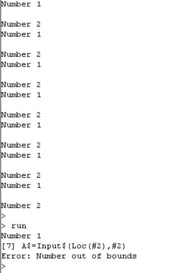

ok I'm really stuck with this one
I KNOW the HC-12 is transmitting data at 19200 baud. I know BOTH HC-12's are working and I know both HC-12's are set to the same paramaters. (tested out of circuit and they talk to each other.
I know Micromite #1 is transmitting this string -
I cannot no matter what I try on Micromite #2 to display anything even on the console output.
This is the code on the receiving Micromite
OPEN "COM1:19200" AS #2 'OPEN COM1 - RF tx/rx From outdoor unit
BOX 9,9,780,460,2,rgb(RED) 'Box round screen
Pin(48) = 1 'Set pin of HC-12 High - ie not connected
for X = 1 to 20
Print "Number 1"
A$=INPUT$(LOC(#2),#2)
Print A$
Print "Number 2"
next X
End
The 2 "print Number 1 and Number 2" statements are there for test purposes.
This is what I get on the receive Micromite
The ERROR Is when I tried this version of the code
Print A$
I really cannot understand WHY I cannot see what's coming in on the com port?
EDIT:
Forget about the HC-12
What I need is a way to display everythng coming into Com1 on the console output
This is what's not working*
Edited by lew247 2016-07-16
Posted: 03:39am 15 Jul 2016
I have HC-12 modules here, I will have a play, but they worked fine when I was playing with them.
Number out of bounds suggests there is no data in the com port buffer to be had.
At the command prompt, type: ? LOC(#2)
If you get a zero back, then there is no data in the buffer, so you get that error.
Based on the fact that the transmitting HC-12 is outputting data, you should easily get something in the buffer if it is hooked up right.
You mention about having Pin48 high - where exactly does that go to on the HC-12?
You normally don't need to do anything like that - the HC-12 is ready to go right away without pull-ups etc.

EDIT: What happens when you type in ? LOC(#2) at the command prompt? (with port open and you trying to get results on the receiving MM)Edited by Grogster 2016-07-16
lew247
Joined: 23/12/2015
Posts: 1709
Posted: 04:11am 15 Jul 2016
0
which I presume it means nothing in the buffer?
