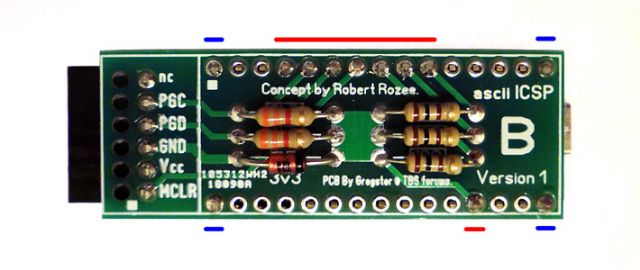

does your assembled board look much like this one?
note the pins that MUST be soldered, indicated by red lines - 7 along one edge, and one on the other edge. the 4 corner (blue line) pins are just for mechanical support. when i first assembled one of grogster's boards i forgot to solder pin 4 and had no end of problems!
also be sure that the zener diode is the correct way round.
Posted: 05:54pm 12 Jul 2016
I solder ALL pins, even though that is not technically required. That saved me having to worry about which ones I needed to do, and which not to bother with. If you solder them all, you are covered no matter what.
My 2c only.

Posted: 11:19pm 12 Jul 2016
Hi Rob and Grogster
my board looks exactly like that. it's probably a good thing I didn't solder all pins because if I have to change over the nano it's less to unsolder. Or I could use the extra board Grogster sent me. Much appreciated.

would you mind posting a photo of the board you have assembled? apart from assembling the nano onto the wrong side of the board (nano goes on side "A", resistors and zener on side "B") there is not much that can go wrong. and the 328p processor itself is pretty tough, so poking around with meter leads is unlikely to cause damage.
rob :-)
