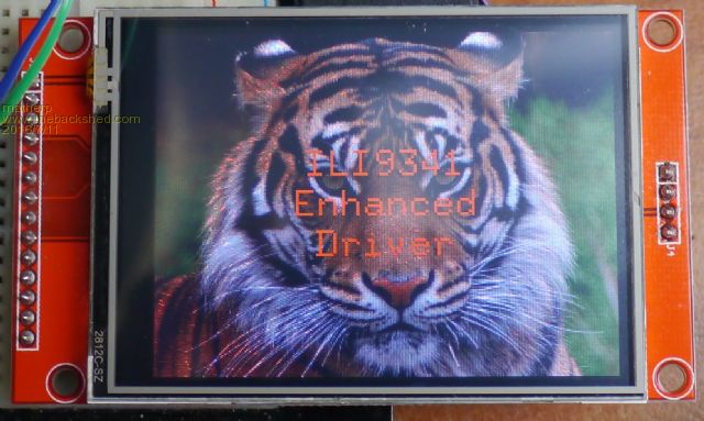

Please view the video to see what is now possible.
This loadable driver adds significant functionality to that supported by the in-built firmware and takes just 8k of memory.
It is faster: CLS takes 186msec using the in-built driver on a MX170 at 40MHz. The new driver takes 93msec
It is more colourful: The in-built driver uses RGB565 (65k colours), the new driver uses RGB666 (262k colours)
It supports transparent text and bitmaps: use 1 for the background colour and only the pixels forming the character or bitmap will be changed on the screen, the background will be left intact.
It supports reading the graphic memory: This allows rectangular areas of the screen to be saved to an array in Basic and then re-stored at a later date.
It supports outputting images from SD card on the MM2: It allows an area for writing to be set up on the display and then a byte sequence of R0,G0,B0,R1,G1,B1....Rn,Gn,Bn can be used to write full colour information to the display.
It supports writing, reading and restoring triangles to/from the display: triangles are the basis of much of advanced computer graphics. The new facilities allow things like gauge or clock pointers and hands to be written as multiple triangles with the option of overlaying the display background.

  Quote  It supports transparent text and bitmaps
Peter this is fantastic and very much appreciated

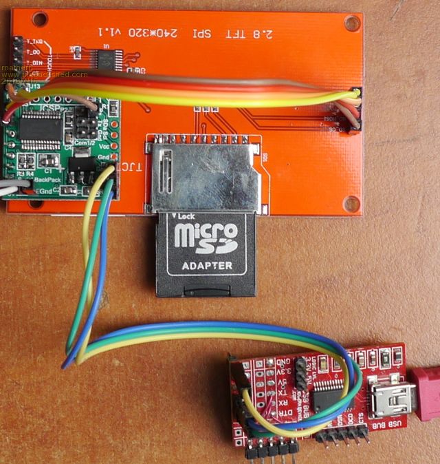

  astro1 said   Anyone seen this come up on a BackBack 28 pin MM, using the code from 12/07?
> RUN
CPU exception #5 at address 0x9D01B764
Processor restarted
Yes, I had the same but Peter's update has fixed it. I now stop at line 170 with:
> RUN
[170] SDcard fileopen,PIC$
Error: Not Ready
I probably haven't loaded something up here though so I'll keep playing - tomorrow. Time for bed now.

I get this with the new code.
> RUN
Error: Not Readyy

  Quote  [170] SDcard fileopen,PIC$
Error: Not Ready
I get this problem if I disconnect the CS pin from the SD card.
Make sure "const SD_CS_PIN = 10" is specified correctly for your wiring and that the pin specified is not in use for anything else.
If that is all correct try running at "CPU 20" or "CPU 10" to see if your SD card is too slow.
Finally, make sure you are using a SDHC card with 4GB or more. SD cards of 2GB give a problem (including with Geoff's inbuilt MM+ firmware)
This is my test setup using one of Mick's serial backpacks
