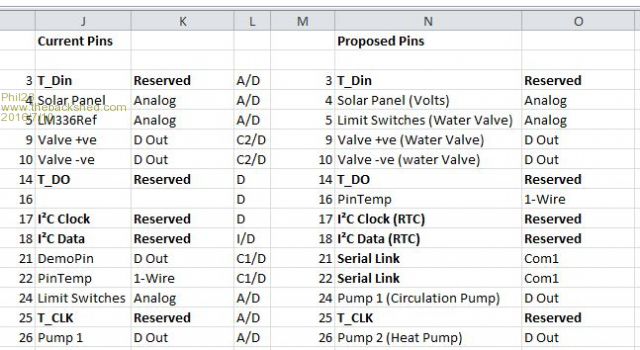

Looks like I've finally run out of pins on my back pack Spa Controller....
One left, & once I do away with the LM336, I'll have 2 which can go Wireless serial coms back to another MM.

Does the water valve -ve have to come from the MM?
Can you not ground-reference the water-valve, and drive it with a high-side transistor switch using only pin9?
That would free up pin10 for you.
It is more then likely I don't know something about the way in which the water valve works - like it is perhaps a two-way valve, and can port water in two different directions or something......

That's it Grog,
It's a 2-way valve. 12v DC operated.
Polarity reversed to change the water direction.
Same applies with the single on/off valves; polarity one way for open the other for closed.
Using 2 SPDT relay modules, wired with their common to the motor, NO contact to +12V; NC contact to -12V
So when both are de-energised -ve is to both sides of the motor. Energise either one to transport the valve.
Transit time is about 10 seconds, then they cut out & I can de-energise the relay once I've checked the limit switches.
As it stand I will just scrape in with Com1 available once I ditch the LM336.

Okey dokey, thanks for that - ground-referencing the valve -ve won't help then.
28-pin device looks like it has a ton of pins, but it's amazing how quick you use them up!
Time to consider moving up to the 44.....
