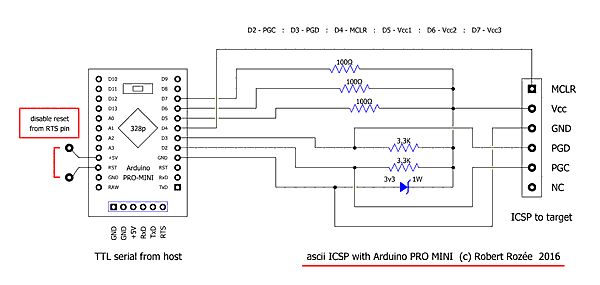

that is odd, D2 to D7 are connected to the 328p processor pins PD2 to PD7 on both the nano and pro-mini schematics i have here, so should in theory all behave exactly the same. even chinese clones should follow the same pin wiring between the 328p and the pins around the PCB.
you should have something that looks like this:
i think i have the above pinouts all correct - this is based upon info from the web, not an actual construction.
(oops: i have RTS instead of DTR marked on the schematic)
apart from Vcc (3v3) everything else worked ok, and your micromite is up and running the 5.2 version of mmbasic?
rob :-)Edited by robert.rozee 2016-07-16

Last part of your question - yes, all working nicely thanks to your schematic. I just add power elsewhere to the backpack currently. I'll be having a look at the power side of things tonight. Will advise.
