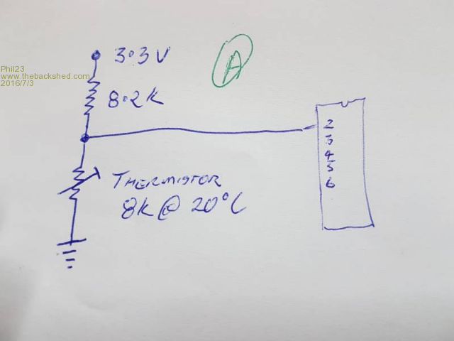

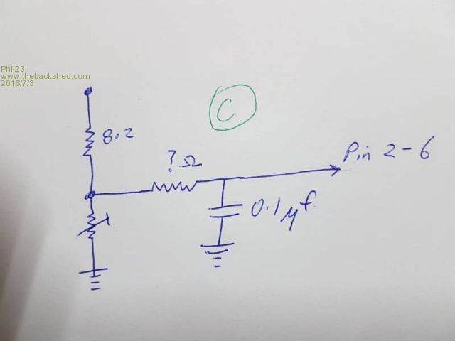

Before I do too much more "Welding" on the board to control my head pump, can I get some advice on how to connect the thermistors correctly.
I've been play with one on a breadboard for a while, so It's basically working, but know there is other considerations.
What I Have so far.
The circuit is this.
I know I should consider filtering on the inputs, but way past rusty there.

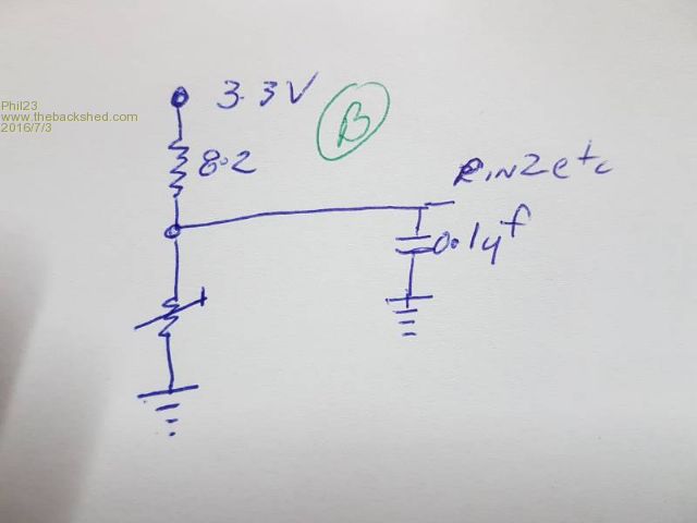

Should I do this?
Or this? With what value resistor?

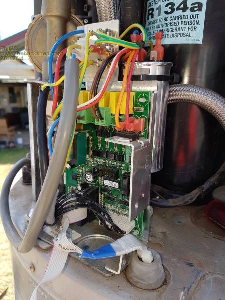

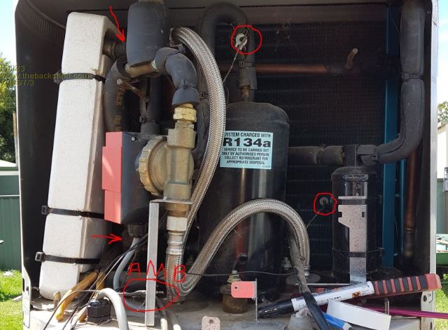

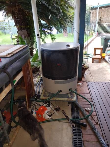

The Heat Pump contains 5 thermistors, 4 of which are installed in a manner such that they are not easily replaced with digital sensors.
Their prime purpose is monitoring temperatures to protect the compressor from overloading & the evaporator icing up.
So they are buried amongst the 240V components to an extent.

My approach to this would be in three areas:
First, make sure the voltage on AVDD is clean. Use the circuit on the colour Maximite with a resistor and capacitor. Have just a single point of connection between Analog ground and the digital ground. Don't just use the analog ground as part of a single ground plane.
Second, it is probably worth having a filter on the inputs 1K + 0.1uF should be OK
Finally, and most important is the wiring to the thermistors. I would use two core twisted pair wire with a separate shield. The shield should be grounded at the Micromite end and left open at the thermistor. The two cores then connect to AVDD and Analog ground.

Phil,
If you have enough filtering on the input then twisted pair is not important. The lowest frequency you need to filter out is 50Hz, so set your filter cut-off around 10Hz and you'll be fine. This corresponds to 1K series resistance with 15 microfarads across the input. With that sort of filtering your reading will still settle at the right value in a few seconds.

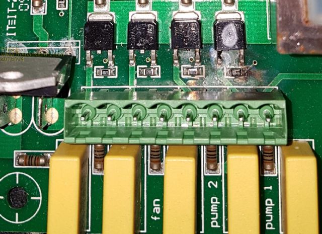

  centrex said   Hi Phil
Just a question Why would you not allow the current thermocouples to control the heat pump via its own controller and just turn the power on when heat is required?

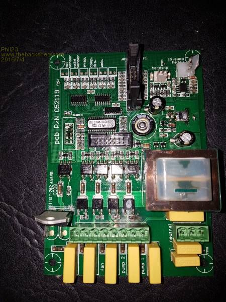

The Smoke has escaped from the original controller.
Not even worth considering repairing, as they have a bad reputation, but also, as seen at the bottom of the first picture, it also reads tank sensors connect to the ribbon cables.
I believe the circulation pump fails first, if not routinely cleaned,
(as if owners will do that), then it's MOSFETS or whatever from there.
Can't see why this should happen, as in the event of the pump seizing, the controller should see heat exchanger input/output differences that would indicate a fault.
My modified version does away with the storage tank & original circulation pump.

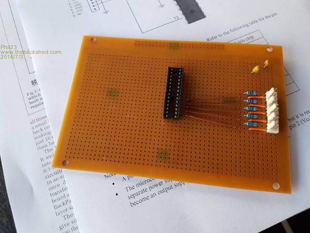

Ok,
Have done that. Correct?
Gnd => 0.1µF => Pin 28 => 10k => 3.3V Bus.
[Quote]Have just a single point of connection between Analog ground and the digital ground. Don't just use the analog ground as part of a single ground plane.
[/quote]
Ground side of thermistors is already wired to a 0V bus, I can isolate that strip, then take it to pin 27, but where else would you recommend?
[Quote]
[/quote]
Had already added the 0.1µF caps in Drawing B when I got back to this post.
So at the moment it's essentially across the thermistor & earth.
Was going to guess on 5 to 10k for the series resistors considering the thing will be in near the compressor & 240V 50Hz.
Is that not a good thought?
I can still change the wire links seen in the pic with series resistors, but would like a bit more advice first.

Also, realised 10k in series with the thermistor divider circuit would give a 159 Hz cut off.
47k would cut off at about 34Hz.
Is that Ok, or am I on the completely wrong track here?
I've already added the 0.1µF from the analogue pins to ground.
Phil.
Edited by Phil23 2016-07-05
Posted: 08:55pm 04 Jul 2016
  Quote  Also, realised 10k in series with the thermistor divider circuit would give a 159 Hz cut off.
Don't go with high value resistors. This increases the input impedance beyond the 10K limit at which the PIC ADC works properly. If you really need a lower filter increase the capacitance instead.

Posted: 11:24pm 05 Jul 2016
Sorry there are no easy guides to this. In fact the recommendation is 5K for the MX170. See AD17 on page 275 of the MX170 device manual
The 10K comes from AD15 on the same page
However see note 1
