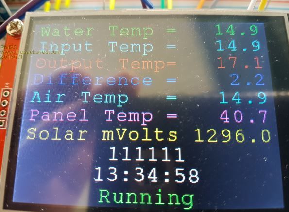

One of the reasons I decided to setup the Flags was so I could view some system status while developing the control logic.
Once I add the heat pump & motorised ball valves there will be a lot of status to monitor & observe.

Yep - got it running nicely.
Took a while for me to 'tune into' your offering, but once there, this is a very useful bit of code.
Thanks - should prove useful for the other Phil
