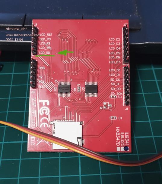

First things first - this only works on a SSD1963 display in which the RD pin is connected to the Micromite (like the Explore 100 )

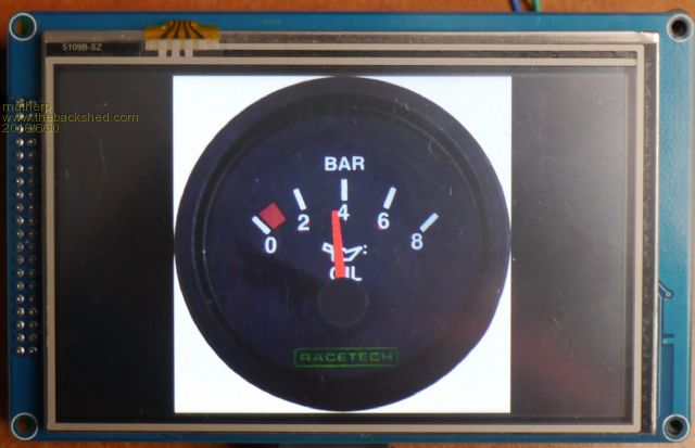

The program works by overlaying a Micromite generated pointer on top of an image of the display loaded from SD card.

The main loop starts by clearing the display and loading up the background image of the gauge
cls
load image "rtecop8.bmp",X_left,Y_top
2016-06-30_154821_rtecop8.zip
In my example code the program just sweeps the pointer from 45 degrees left of centre to 45 degrees right. Normally of course this will be using some sort of data reading to drive the display.

Posted: 09:44am 30 Jun 2016
I think you have a serious issue with the oil pressure in your car (or plane)
Seriously, I think you need to get some sleep - don't you ever stop??
This is amazing stuff. I reckon Zonker will be impressed with this (as will virtually everyone else).
Great stuff once again . . . .

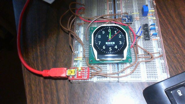

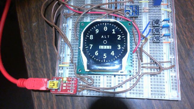

Posted: 05:08pm 01 Jul 2016
Yes Sir.. I like the awesome work Peter has done with all the different displays..!
I managed to get a week off work and will be spending some time trying to get an ALT gauge going with the BMP180 sensor that just showed up on the slow boat... Peters new driver code for the R61505V "round" displays I hope will work in the same way...
After doing the background screen layout, I hope to use a modified version of Peters "Tiny Ben" demo code to move the altimeters needles over the background screen without disturbing anything... I modified the PCB like Peter did to connect the RD pin and need to change the code to use 10 revolutions instead of 12... Maybe change the look of the needles... Still trying to understand all the usable functions inside the display driver... there could be more questions along the way... (fun stuff)..!!
Thanks again Peter for all the fine work you have done..!

Thank you very much Peter for the driver updates..! As soon as the new Grogster E-100 board arrives, I will spend some time on the on your test program.. Looks awesome..!
I have also sent the "rev B" round gauge board out to get 15 made that include the RD pin changes... Attached are the updated files if anyone is interested...
2016-08-08_101308_EIS_Round_Gauge_MPU_Rev_B.zip

and has anybody found another supplier of the round LCD? Zonker's nominated supplier no longer stocks them in that size and resolution.

Yep... I found them on AliExpress and E-Bay BUT... Compared to the earlier price of less than $4.00, the new prices really SUCK..!!
"Zonker NOT happy"
Not sure what to say about all this.... Will keep searching...
EDIT: - Also at Alibaba but no price on them.. Selling in lots of ten... I have a quote in for 100...Edited by Zonker 2016-08-10

They are all 1.38", compared to the 2.2" you have now. Getting a bit on the small size for me.
