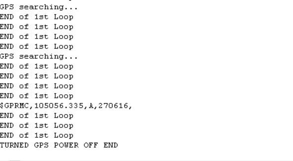

WHY isn't this working?
It does the GPS routine perfectly
It turns the GPS off after 60 seconds which is what the gps subroutines tell it to do
[quote]TURNED GPS POWER OFF END of B3[/quote]
It just won't get to the 2nd Loop which is simple a PRINT statement for testing purposes

Posted: 11:20pm 26 Jun 2016
Your second 'Do' loop does not have a condition so it never ends.

It does ALL of Loop 1 (get gps stuff) and it gets to the end of Loop 1 where it prints TURNED GPS POWER OFF END
But won't get into the 2nd Do statement/loop (print "got to 2nd Loop")

Interesting it's stuck in a loop at Print "2"
[quote]END of 1st Loop
3: 14
2: 14
END of 1st Loop
3: 14
2: 14
$GPRMC,112939.791,A,270616,
END of 1st Loop
3: 15
2: 15
[/quote]

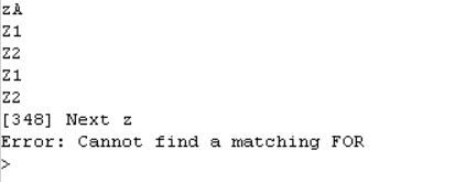

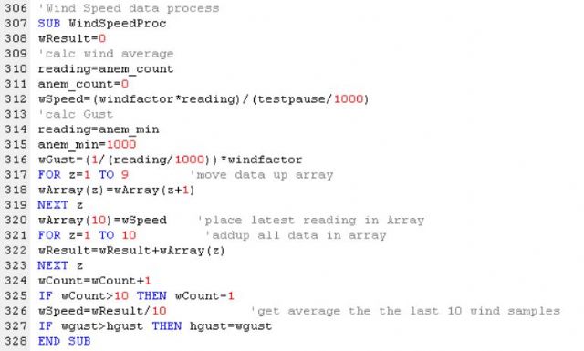

Why would a "FOR" statement not register?
a section of code (the prints are there to test where it fails)
[code]
For z=1 To 10 'addup all data in array
print "Z1"
wResult=wResult+wArray(z)
print "Z2"
Next z
[/code]
result is its adding the array up as I can see by the zA, Z1 and Z2 prints but when it gets to next z if think's there's no "FOR"

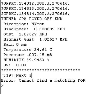

EDIT:
I only get this if I put the "turn gps on section" into a subroutine and not when it's in the main program loop
The section it fails on is nothing to do with the gps at all, it only goes to that section after the gps is turned off
Edited by lew247 2016-06-28
Posted: 03:16am 27 Jun 2016
  Quote  think's there's no "FOR"
What version of firmware are you running? - I seem to remember this was a bug in one version but may be miss-remembering
