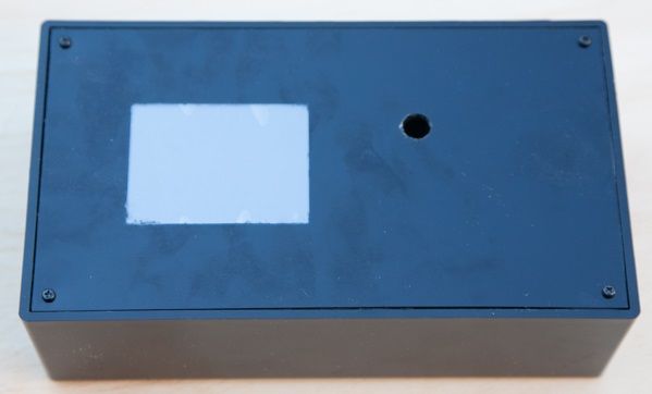

Ok, here are some photos:
This is the R2-D2 I made, just to show you what is possible:
This the finished product:
Note: the clear plastic is a first attempt and I mucked up the paint job, get a bit under the sticker. I am getting better at that. I also left the protective film on the LCD panel, as I am still working on this project.

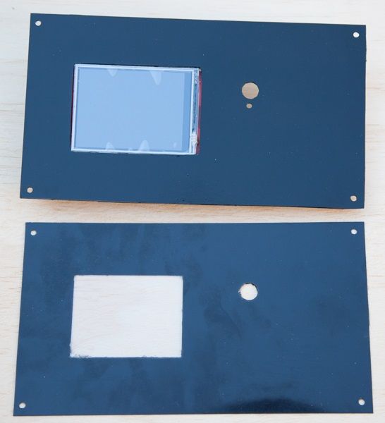

When you remove the panel and clear panel, it looks like this:

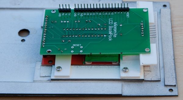

Behind the front panel looks like this:
On this panel I have just added padding under the board to get the front flush. I have then added some pieces on either side of the panel, then secured the panel in place with strips behind it and self tappers. On of the strips I have turned into a bracket with holes that I can bolt through the backpack holes. I plan to attach my circuit board to the backpack using spacers.

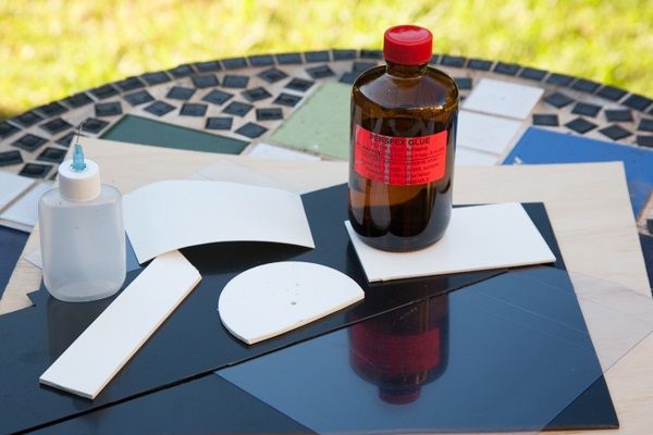

Here are some styrene offcuts:
I have black and white styrene and clear plastic as well as a well used applicator bottle and the solvent glue. This is not the weld-on glue that I normally use, but it was all they had last time I was there, and it works just as well. You can see a range of thicknesses.
