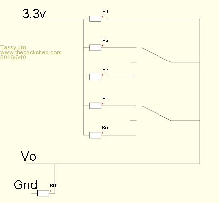

I'd like to check the limit switches on a couple of motorised ball valves & looking for suggestions.
Each valve simply has a SPDT limit switch, so 4 wires back to the micro would do it, but I'd like to get it done on a single wire.
Partially to save on IO pins & also to save on cable cores.
If I did everything the simple way I'd be needing about 12 cores so far.
At the moment I'm using 6.
What I'm thinking is along the lines of the Transmission position switch in my car.
It's basically a 7 position rotary switch with a bunch of resistors in series to create a voltage divider. The contact slider is designed so the is no nul value between positions. (Yes, I've pulled mine apart.....).
What would be the best way to wire these 2 SPDT switches to get a similar resistance scaled output that and be read?
Something that needs to be taken into account is the switch being in the in between position, as the valves take roughly 10 seconds to change position.
A 4 pole rotary switch would be easy, there's either a pole connected, or the Nul between positions.
With the 2 limit switches, either or both of them could be in the nul position.

I think this is what you are after
With the correct values, you can cater for all 9 possible combinations.
These values (in k ohms)
R1 100
R2 22
R3 2
R4 10
R5 1
R6 1
gives
2.856018883
2.972972973
2.049689441
3.126614987
3.267326733
2.185430464
1.605484299
1.641791045
1.314741036
these 9 voltages.
There will be better choices of resistors.
Open circuit cable gives 0 volts.

Thanks Jim,
Will play with the values.

Using an analogue input will be prone to noise pickup. The 1K0 resistor (R6) Jim suggests will at least keep a low impedance at the input.
Keep in mind that you are running an antennae out into the field. Be careful of cable run. Route away from all sources which are likely to induce a voltage into the cable.
Filter your input signal in hardware, and software, and use clamp protection at the input.

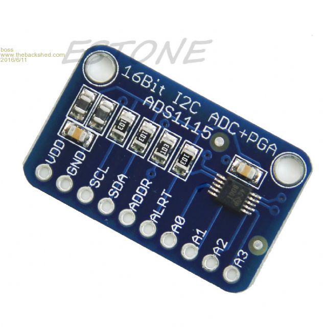

@Phil
try this
ADS1115 4x 16bit A/D, I2C, ~$3.50 on Ebay.
Bo

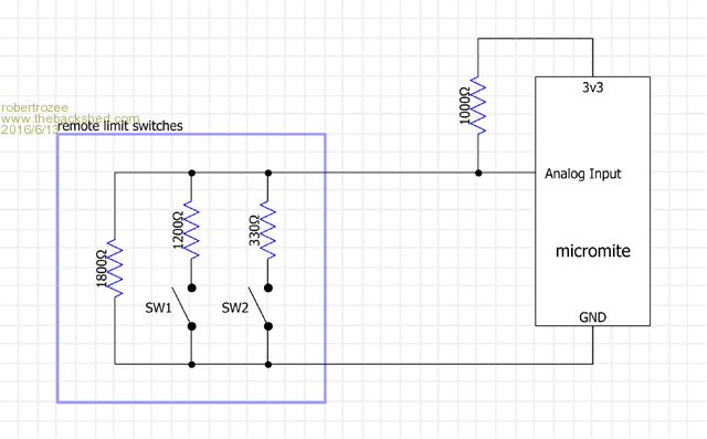

regarding the original question: motorized valves with limit switches (2 per valve), with approx 10 seconds between limits while valve is in transit; i'd suggest the following:
with both SW1 and SW2 open, about 2.1v will be present at the analog input, with SW1 closed there will be about 1.4v, with SW2 closed there will be about 0.7v. under fault conditions of the wiring from the micromite open-circuit there will be 3.3v at the analog input, while a short will result in 0v. these voltages are what the micromite 'believes' are present, and are independant of Vcc. no external reference or precise Vcc should be needed.
the wiring 'cost' is a twisted pair to each valve, and 1 analog input pin per valve on the micromite. i would recommend against trying to encode more than a couple of switches per analog input.
it is also a very good idea to have the motor travel shut down by a seperate set of contacts on the limit switches - i presume this is built into the motorized valve design? another safety feature is to monitor the motor current.
the below spreadsheet contains the resistor value calculations:
2016-06-13_121906_resistor_values.zip
rob :-)

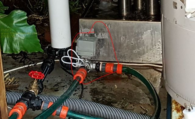

At this point now; motorised ball valve installed.
Courtesy of Teenager on School holidays...
It's 12V DC, polarity reversed to change direction.
SPDT limit switch.
  robert.rozee said   regarding the original question: motorized valves with limit switches (2 per valve), with approx 10 seconds between limits while valve is in transit; i'd suggest the following:
with both SW1 and SW2 open, about 2.1v will be present at the analog input, with SW1 closed there will be about 1.4v, with SW2 closed there will be about 0.7v. under fault conditions of the wiring from the micromite open-circuit there will be 3.3v at the analog input, while a short will result in 0v.[/quote]
Just wondering what values to test for as far as tolerances are concerned?
3.3, 2.1, 1.4 & 0.7 +/- how much?
[Quote]The wiring 'cost' is a twisted pair to each valve, and 1 analogue input pin per valve on the micromite. i would recommend against trying to encode more than a couple of switches per analogue input.[/quote]
That's what I'm planning, 1 valve per pin. Avoid the encoding of multiple valves.

Posted: 02:22am 06 Jul 2016
use something like this:
setpin 2, AIN
do
v=pin(2)
if v<0.4 then
print "short to ground"
elseif v<1.1 then
print "SW2 closed"
elseif v<1.8 then
print "SW1 closed"
elseif v<2.7 then
print "both switches open"
else
print "open circuit"
endif
loop
note that the case of both switches being closed at once is not distinguished from just SW2 closed, but this situation could only occur if there was a mechanical failure in one of the switches.
rob :-)Edited by robert.rozee 2016-07-07
