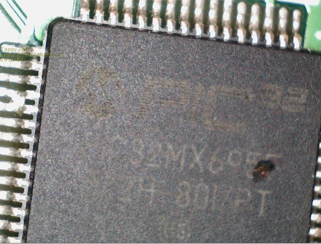

They don't like lightning.
Should I make a warranty claim?

@TassyJim
Lame. I expected more.
