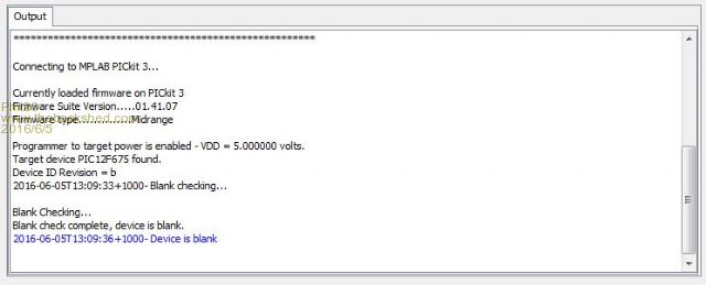

Posted: 05:13pm 04 Jun 2016
Finally got to check this out again on a rainy day......
No Wonder it doesn't work......
I'm sure I'm reading it correctly.
Cheers.

  Gizmo said   You know, I really hate how every bloody SC project these days has to include a pic chip!
Rant over.
@Gizmo
I'll take over the Ranting from here....
Might be time for some "Outside Time" to avoid the temptation of paying $3.00 for the firmware off SC on a Sunday...

Since this is a learning project, now is your chance to learn some PIC12 assembly. The circuit sounds simple so the firmware should be pretty simple too. The only potential difficulty is the output signal for the noisy part - is it simply on or is a particular frequency pulse train needed?

If you want to reprogram the PIC the hex file should be available from the Silicon Chip web site.
Paul.
