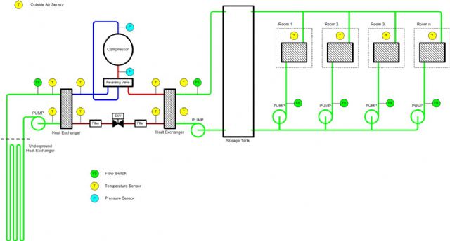

Hi Paul,
I think I've got the included drawing right based on your functional descripton.
My background is refrigeration, air conditioning and building management systems.
Definately two MM+'s with 7" touchscreens. One for the left side of the storage tank and one for the right side. Right one could have RTC, for time scheduling, an SD card for data logging and an RF module to suck out the data, probably in csv format ready to slot into an Excel spreadsheet. If your data is setup correctly in an array it will be a simple matter to transfer the array from the left MM+ (condensing unit) to the right MM+ (indoor coil control) onto an SD card and then on to your PC via RF. The right MM+ would also look after the room Temp sensors and associated coil pump control. I can see the graphics now !!!!!
The left one would look after the condensing unit. I would start and stop the unit based on the temperature of the water as indicated by the sensor located between the storage tank and the heat exchanger pump (bottom of tank in drawing). The condensing unit would not be allowed to start until the flow status of BOTH heat exchanger pumps was proven. Would recommend flow switches for this task. I would ditch the expansion valve if you can, and fit an electronic expansion valve, that way you could precisely control superheat. Cheap stepper motor drivers are readily available (do a search for Pololu) and could be hooked up to a PWM output, or pulse an output in conjunction with an interrupt, of the MM+ to output the desired number of pulses required to maintain superheat. You'll notice I have included enough temp\pressure sensors to achieve this. Otherwise keep the TXV but the sensors are probably still handy. The pressure sensors could provide for high, and low, pressure cutout. Likewise for the Temp sensors. Setup a serial comms link between the two and you'll have your very own BMS. Geoff has included enough interrupt sources to do ALL that you require......and some.

Hi Mike,
Thanks for your reply. Your drawing is almost exactly what I'm dealing with and your suggestions are well thought out.
