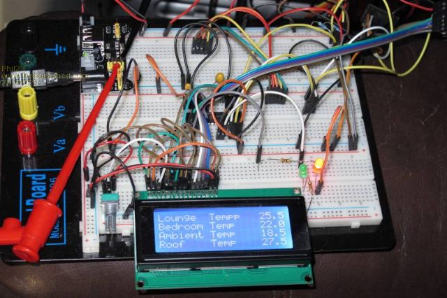

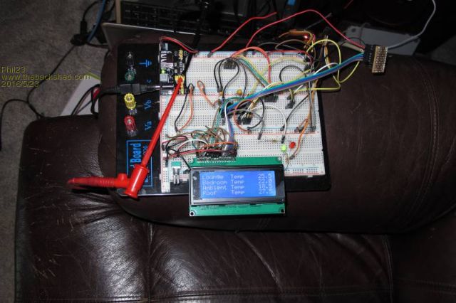

It is still a giant Birds Nest on a breadboard at this stage; Sitting on my armrest.
Not using an LCD Touch screen yet, as I wanted to play with one of the older modules.

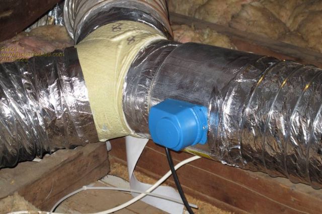

But it does have cabling up to the hardware in the roof.

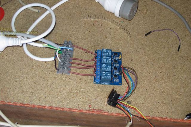

As mentioned in another post, the relay module can drive the fan on either low or high speeds, & also opens & closes damper valve.
At this stage ducting is to the Main Lounge & Kitchen/Dining rooms which are fairly open planned.
The motorised damper closes the ducting off when the fan is not running to prevent heat loss.
The fan draws 105 Watts on high & displaces 840 cubic metres of air per hour.
The main living area, plus adjoining Office/Spare bedroom have a total volume for 215m³, so air turnover is about 4 times per hour.
An inlet filter for the fan is work in progress, but there is little transfer of dust as it is not disturbed by the fan action.
More vents & dampers are to be added, along with a return air vent including damper.
Only using 2 Temp sensors at this stage, just wired to individual pins, as the each room sensors are not in place yet.
5:00am this morning it was 18°C inside & the fan kicked in around 8:30, when the ceiling temp reached 20°C, (Differential coded at 2°C)
Only running basic code at this stage, as I decided to re-write from the ground up last night. The other code I have will be brought in later.

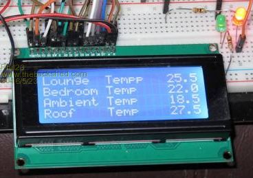

The photo taken at about 4:15pm shows the Inside temp as 25.5°C, on a not so warm day that barely saw 20°C. Not bad heat recovery. 24°C was reached in about 2 hours.
The Green LED seen in the pic inverts with every cycle of the main loop to indicate the code is running, and is held on while the Temp sensors are being read.
The Red one indicates the fan is running.
Like I mentioned, the code loaded is only basic, but I want to add the other components back in in a tidy & orderly manner.
At least it's running & cutting back on heating expenses.

I would keep an eye out for some better relais. I have had the exact same ones failing on me several times, not sure if it was the optocoupler or the relais itself.
If they are in important (critical) places maybe opting for a solid state relais might be better. It should be an easy replacement once needed.
Phil23
Joined: 27/03/2016
Posts: 1667
Posted: 03:03am 23 May 2016
  MicroBlocks said   I would keep an eye out for some better relais. I have had the exact same ones failing on me several times, not sure if it was the optocoupler or the relais itself.
Yes I don't place a real lot of faith in them.
Contacts are rated at 10 amps, not sure what the PCB tracks would handle though.
Current thru them is low at least.
Is there such thing as a double throw Solid State Relay?
I use the NC contacts on the damper relay to feed it's drive close motor.
Other thing? Am I wrong in using pins 2,3,4 & 5 in as DOUT, OC to actuate the relays when the VCC to the relays is 5 volts?

  Quote  Other thing? Am I wrong in using pins 2,3,4 & 5 in as DOUT, OC to actuate the relays when the VCC to the relays is 5 volts?
As your relay board is opto-coupled, you could just use direct outputs to drive the LED in the opto without issues. However, having them set as OC won't hurt the situation I wouldn't think.
