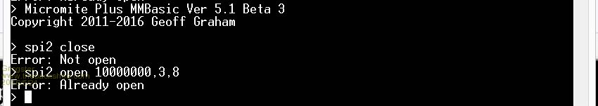

"MMBasic Ver 5.1 Beta 3"
ummm, shouldn't you be using the release (non-beta) version of 5.1? or the 5.2 beta?
rob :-)

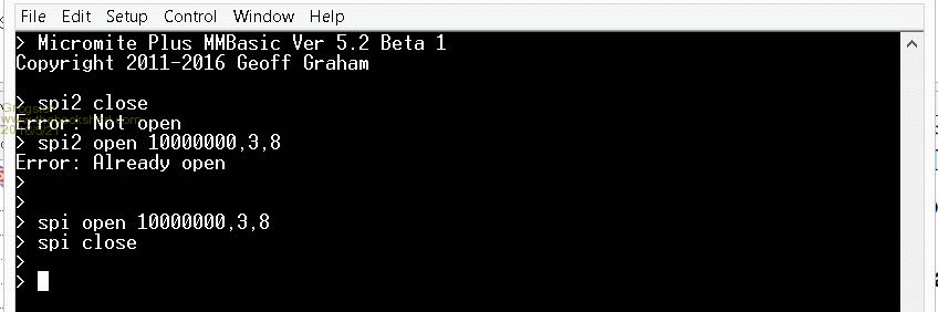

Excrement, that's a point.
Latest I have here is 5.2 B2 for the MM+.
It would not hurt to flash the new one in, so I will do that and see if that cures the problem.
EDIT: Nope.
